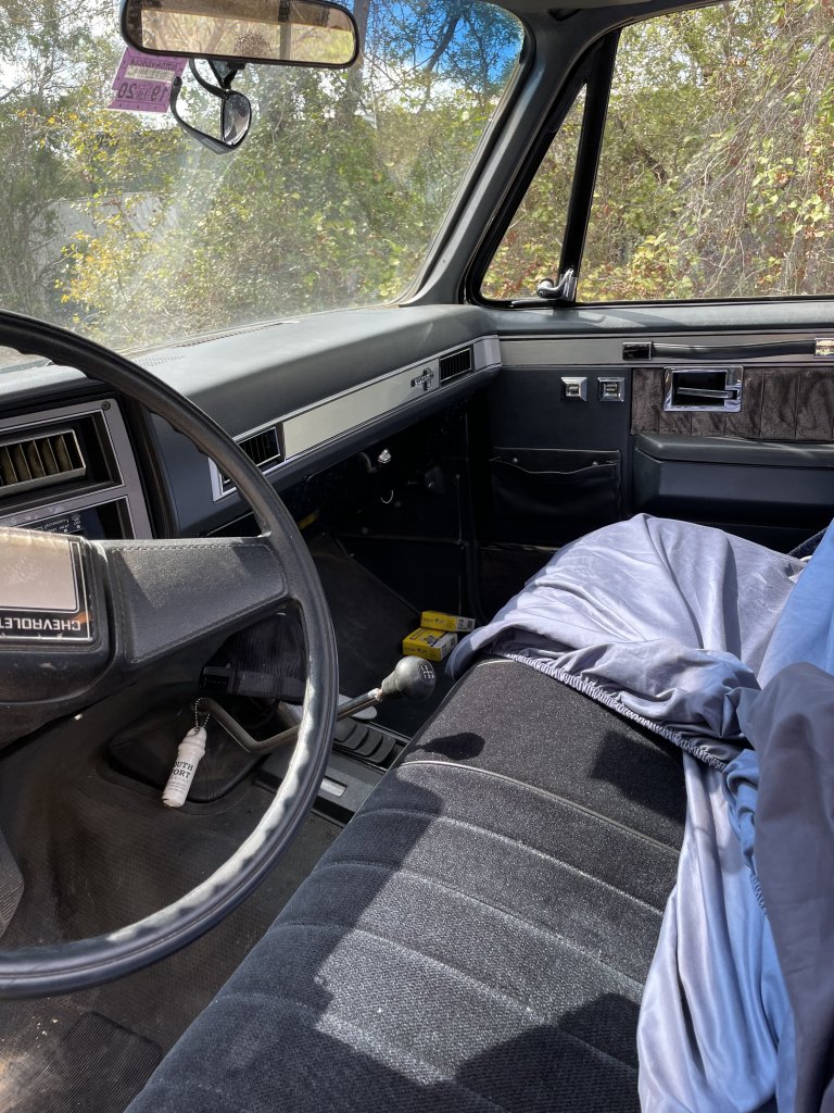

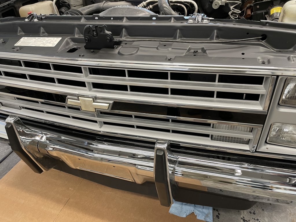

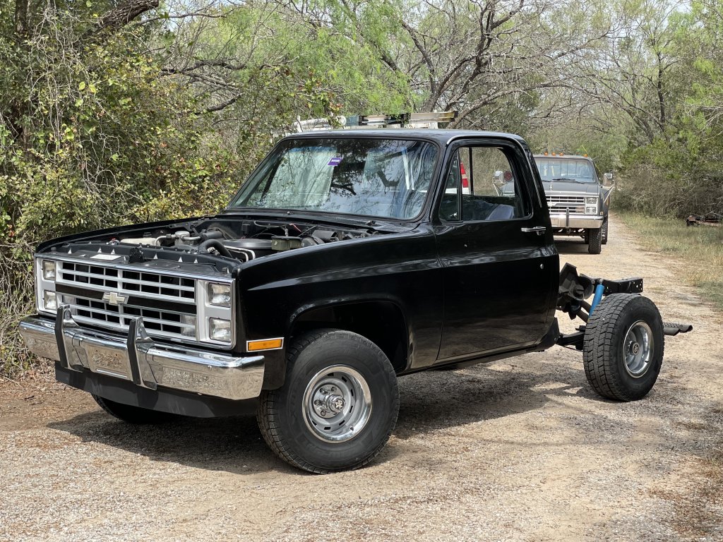

Finishing up with the restoration on my 1987 shortbed Stepside 4X4. I’ve ordered the new bed wood in pine and was wondering what color stain (if any) and what kind of UV resistant sealer to use? Trying to keep it as original as possible without painting it black (factory they came painted). Thought maybe just to seal it with a quality Marine product and forget the stain.
thoughts?
