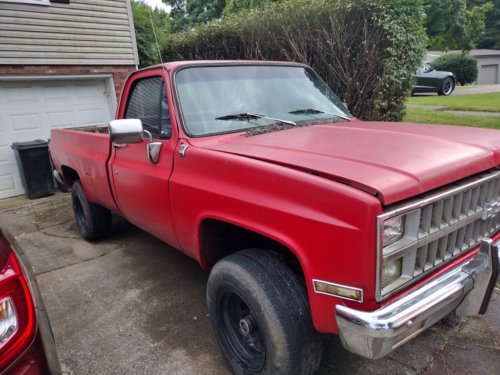

I have an 81 K 10 with a 305 and I need a new block. Does anyone know what years I can use for the block replacement? Since I'll be using the old heads and intake can I use a block from a newer vehicle or will the dimensions be different?
