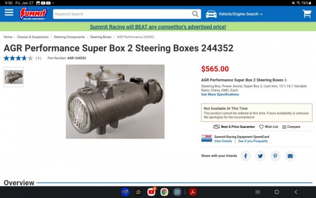

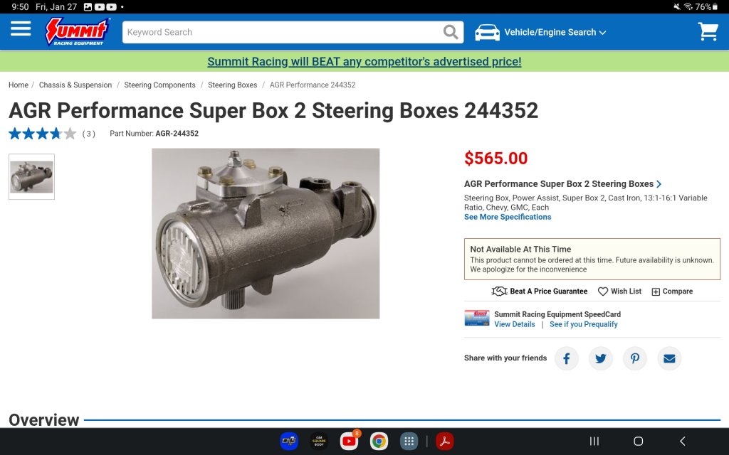

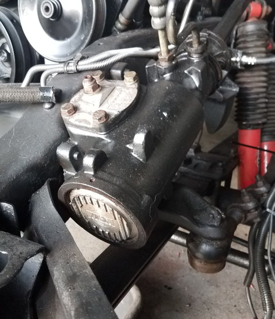

I went with this steering gear from summit racing. Working great for the past 4 years.

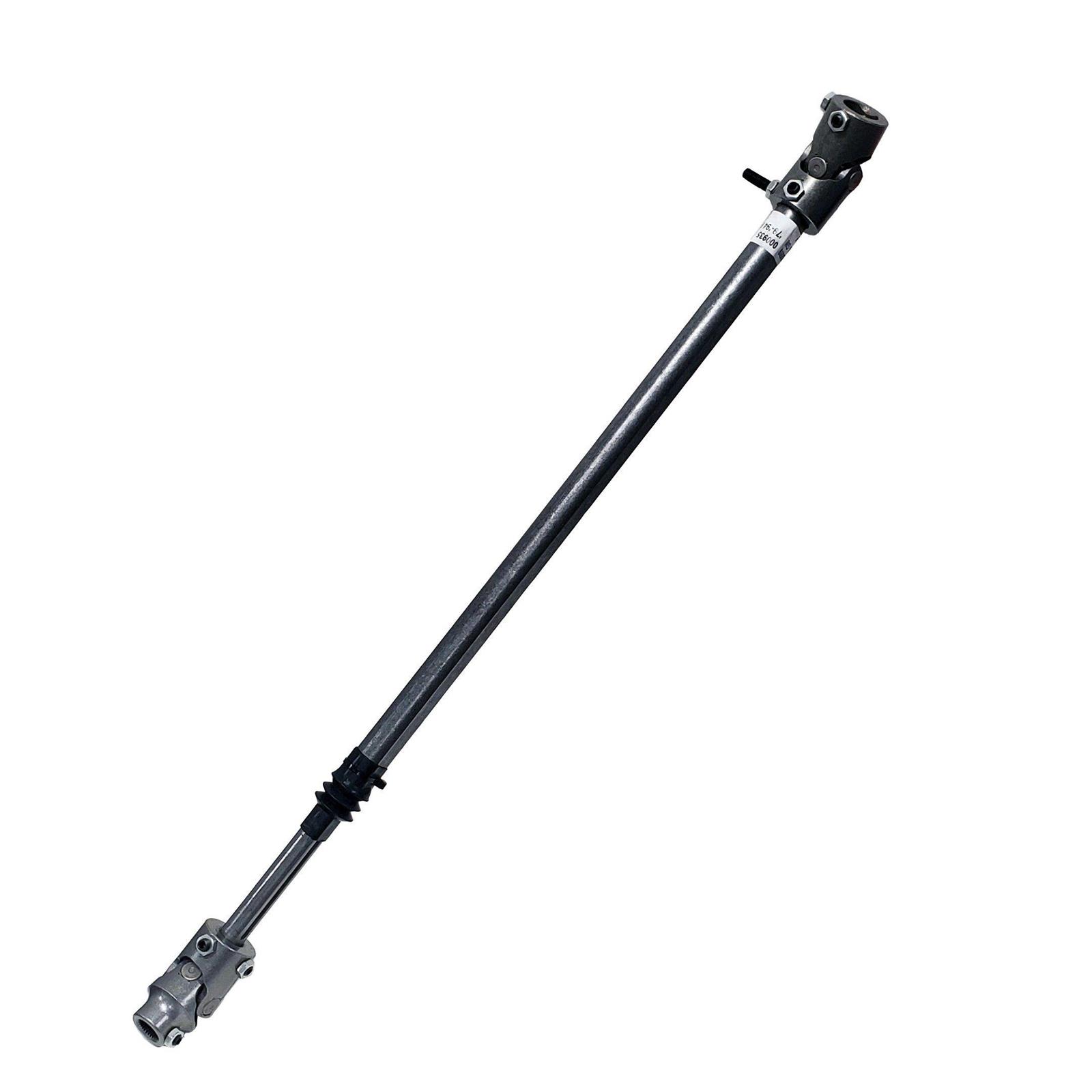

Borgeson also sells the replacement steering shaft with the u-joints. Of course it isn't cheap, but I can attest that it is very high quality.
This will be the very next upgrade for my burb.
Just can't decide whether to get the one with a rag joint or the universal joint on the steering gear side. Any thoughts on this?
