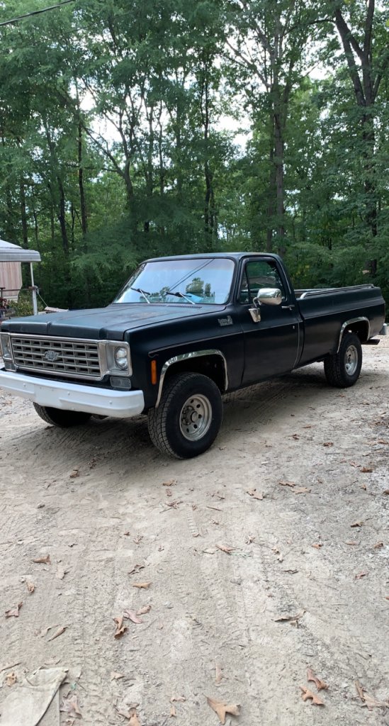

Alright I’ve got another truck with you guessed it more problems. When I bought it I stalled the truck in the road at the guys house when I accelerated quickly, I assumed it was just because it was still cold. Nope, I had the truck up completely to temp today and it most definitely had less to do with it being cold. Truck is a 1976 k10 with a 350/350/203 combo. In neutral and in park the truck revs up fine other than a belt squeak at the quick throttle. I’m drive or reverse you pretty much have to slowly ease on the throttle or it isn’t having any of it. If I floor it you can bet it’ll stall. It’s a supposed freshly rebuilt quadrajet. I’m not sure what’s happening when you’re in gear that makes it big and stall since this is my first auto. It also bogs when under load, it won’t spin tires in loose gravel, it just spits and sputters. No obvious backfiring. The alternator doesn’t work as it should, at idle I don’t think it’s doing anything, wirh a little throttle it reads fine on the gauge.
