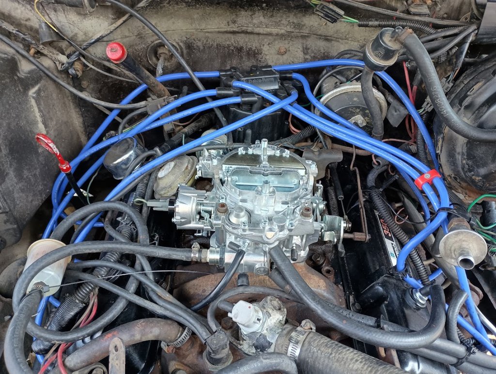

    Hey fellas!,
    Good to be back here...hope all is well with everybody!!
    I need some help with my carb...it's the infamous Quadrajet E4ME computer controlled set up (that I have to have running right to pass smog). Good ol' California....
    However...I pulled my truck out of the garage a while ago...smog is due...and I can not get this damn thing to run right.
    Idles like shit...rich.., cold morning starts are a mess...coughs all over itself..I set the idle up to stop it from falling on its face..then the rest day it gets increasingly higher.
    Try to turn up the fast idle for mornings...just a few ticks..and it won't come down...I turn it all back down and it' s bucking and dying at stoplights. Tried messing with timing and I'm just chasing it everyday.
    Some days I can get it to do good....then it varies the next day.
    Been wanting to drive it on a daily...but I'm fighting it.
    Pulling my hair out over here. It used to run spectacular before I parked it and started restoring her.
    I can not seem to find that spot
    I also notice once I try to make adjustments...the RPM's vary on it's own...it almost seems like it's fighting itself..
    Any ideas...tricks...or anything would help.
    I'm on the verge of just pulling it off and getting a new one...
    I sourced one for $350

    Check for vacuum leaks.
    Is the choke closing when cold and then opening all the way when warm?
    Could be some dirt or grit in a passageway somewhere. Run the engine with the air cleaner off and quickly cup your hands (very briefly) over the carb inlet a few times. The abrupt pressure changes "might" dislogde whatever may be stuck.

    Funny you mention the vacuum situation...I just got off work about an hour ago, and the truck was sitting all day since this morning. It started up and idled good on its own.
    But...it increasingly got higher, and wouldn't come down at all. So...I grabbed my handy long screw driver...loosened the air cleaner to turn the fast idle down and when I moved the cleaner up the idle dropped and acted weird.
    I wiggled the air cleaner some more and it fluctuated.
    Now..I'm wondering if I do have a bad hose or something is rubbing when I mess with the air cleaner.
    I can see at least three vacuum ports with lines on my carb.

    I think I'm going to inspect all vacuum lines..it does seem like it might be. It runs like it wants to cure itself...like it'll idle real good for a couple of stop signs...then the third stop light...it's back to loading up and smelling rich.
    I keep twisting on idle screws chasing it...but It's just to erratic right now
    Need some time on it
    As far as the choke plate goes...the other day when I was tweaking with it..it wasn't opened fully...I mean not straight up and down...but it was opened enough and at operating temp.
    Not sure about cold choke fully closed.
    Need to inspect that in the morning
    I know there's an electric choke that I can adjust..not sure if I want to dive into that one.
    Also..the CHOKE light is on...which I know shouldn't be. It stays steady lit too....that's a big clue

    If your choke light is on you should check for power at the terminal on the choke thermostat. The electrical power runs thru a oil pressure switch If you have no power at the terminal there is a fuse for that to check first and then check the switch itself if the fuse is ok.
