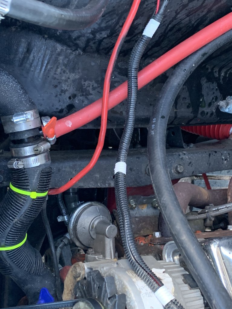

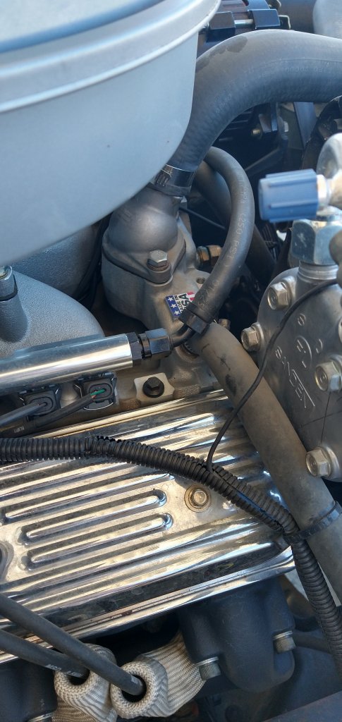

I am trying to get heat on my 87 and it doesn’t seem to circulate correct no matter what I do! Should the 3/4 coming off the intake pump water while running? I would think so because it’s right beside the thermostat that flows when open. New thermostat and water pump. Everything motor wise works perfectly. I used a new mishimoto radiator I had for a Cummins but that should not affect the heater core/ system. With that intake line off I can blow coolant through the heater core!!!! Thanks in advance!! The black line from the intake to core and red from core to lower radiator hose.

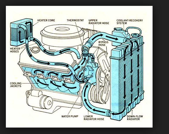

According to this diagram, coolant should be flowing out of the intake hose ??! Any input????

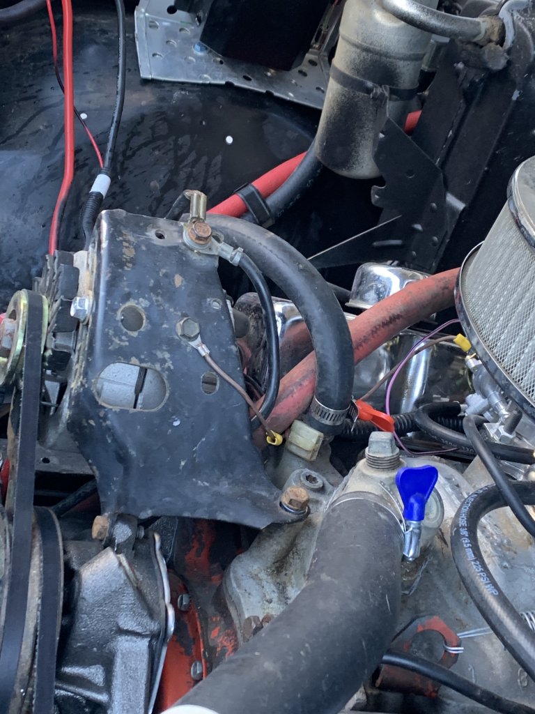

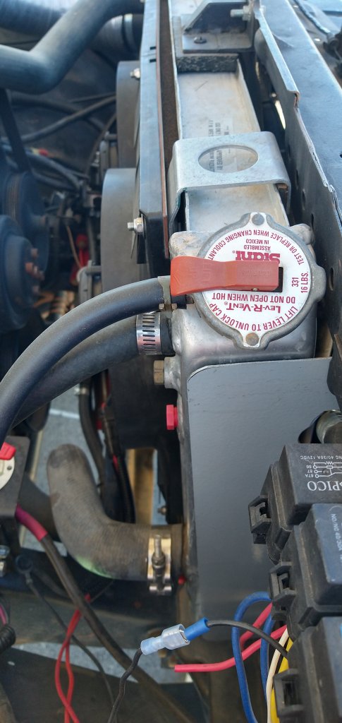

One thing is for sure. I would temporarily remove the t-stat, leave the hose off the nipple coming out of the manifold and start the engine. If nothing comes out, it can only be pump. However, remove the rad cap and see if coolant is actually circulating. If it is, your hose routing isn't correct. I would move the return hose from the heater to the return side of the radiator. There should be a nipple there. You may have caused a cavitation loop by t-ing it into the lower radiator hose.

no nipple on the radiator because I used the non stock radiator. I figured if it could go into the radiator- why not the lower radiator hose. Same route of circulation and it allowed me to used the bigger radiator that I already had vs buying a new one. Everything circulated through the motor fine and dandy even with the thermostat in place.
