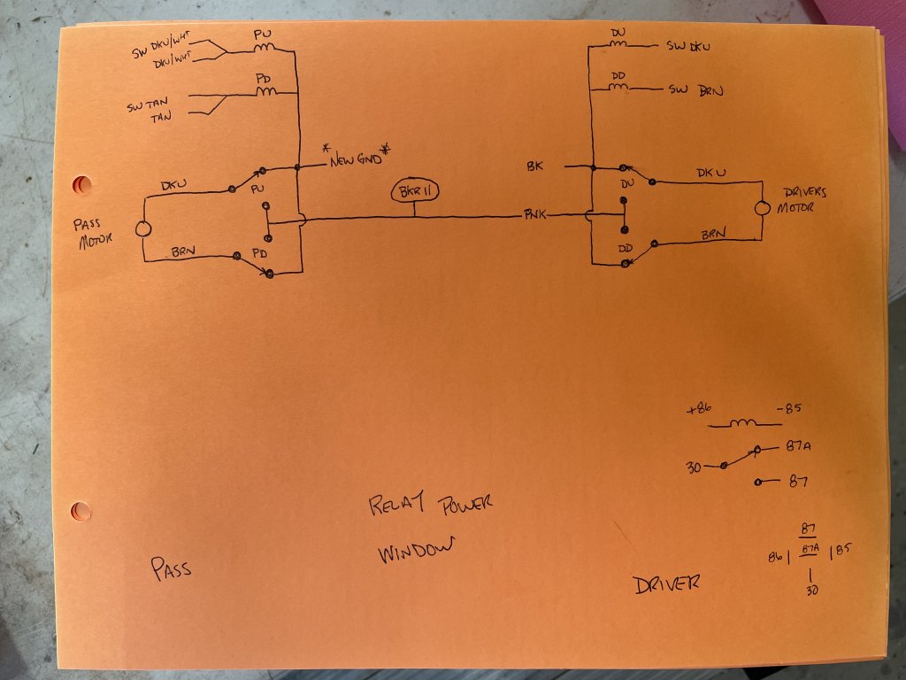

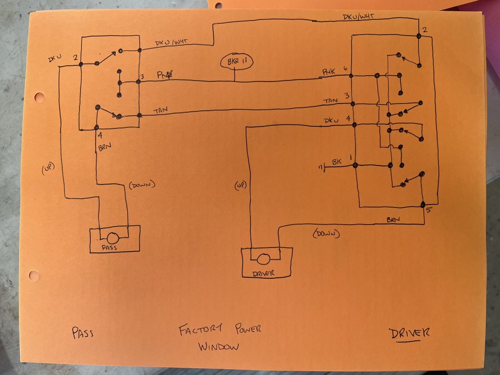

wlwarnke
Sep 14, 2021
132
183
Helotes, TX
William
Not sure what year you’re working on, but I assume they’re all the same.
The drivers door has the heavier ground wire. The passenger door, (usually the slower to drive), has the pass through 2 switches (one in each door) to get to ground.
At rest, both pins on the motors are grounded. When up/down is pressed, only 1 pin get switched from ground to +12.
Here is how I added relays for mine. Note I only added a new ground to the passenger door. The power to both doors and the ground to the drivers door was plenty sufficient once connections were cleaned up.
