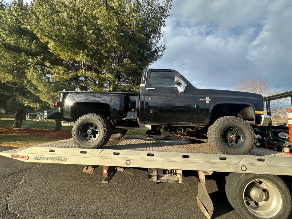

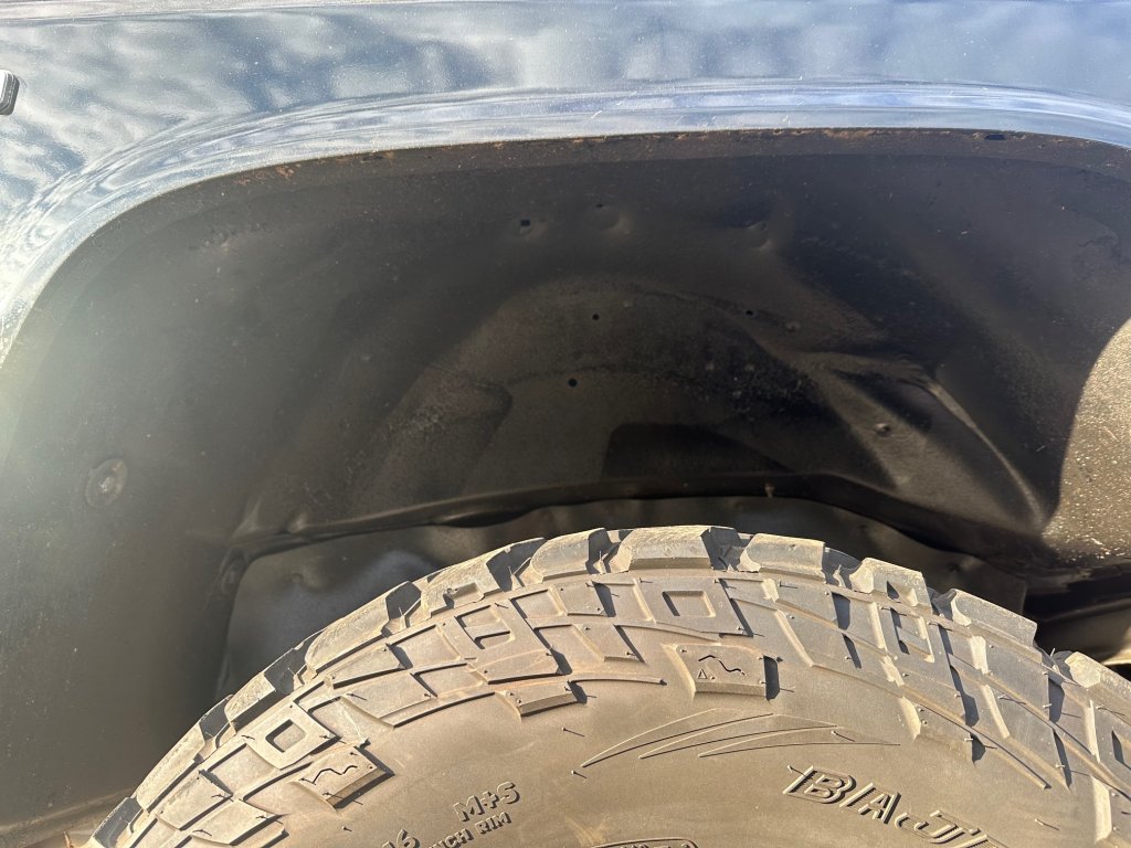

Here's what I'm working with... it currently has 33" M/T mudders (305/70R16) on it and I'm trying to get closer to the stock look and stance. But, I have it at a shop now for a bunch of mechanical work and they told me the truck doesn't have a lift. I didn't ask about shocks and if those were replaced with something else. Does it look like it's sitting higher than stock, or is it just the tires?

I would find a new shop cuz that definitely has a lift, they don't know what they're talking about. I'm gonna guess a 4" lift
This. They’re not super knowledgeable if they can’t tell it has a lift. And, I believe the 4x4 rally wheels would be 15x8.

Its probably lifted properly- arched springs and not lift blocks, so it looks factory.

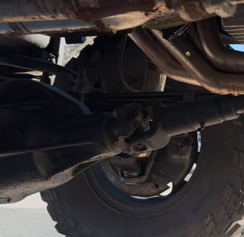

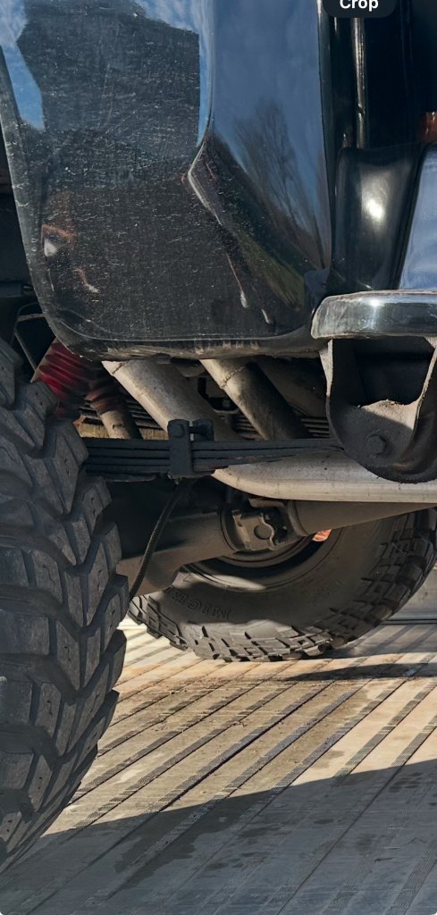

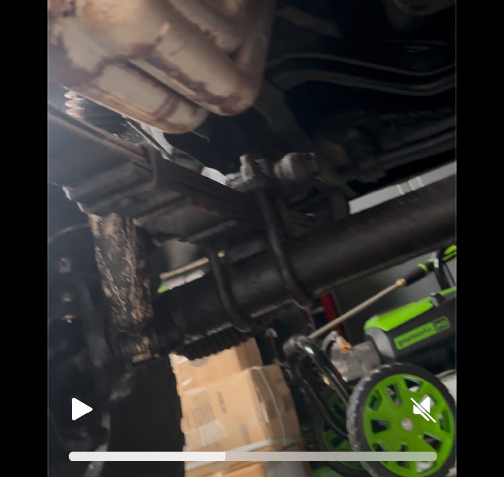

I’m not with the truck until next week, but I have a few (poor) pictures that kind of show the leaf springs. Anything you can tell from these?
Front springs are definitely aftermarket, too many leafs and stock springs are nearly flat when the vehicle weight is on them.
I can’t really tell much about the rear from the picture

Definitely lifted.

It's either a 2.5" or 4" lift, based on the front springs. I could pin it down with better pictures. I'm currently leaning more towards 2.5".
Stock rally wheels would have been 15x8. There was a 15x7 offered in some years, but incredibly rare. If it had basic steel wheels, they would have been 15x6. There was a 15x8 basic steely too, but I think by the 80's, they were only used on the military K5's.
