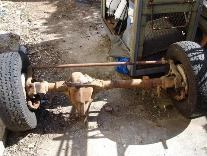

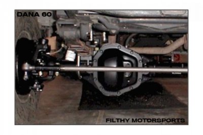

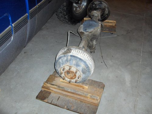

I have spent a lot of time explaining to people how to identify parts so I thought this would be a good thread to start.
it is easy for me to identify them just at a glance but a lot of people don't know a dana 60 from a 10 bolt.

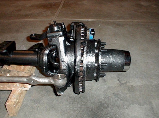

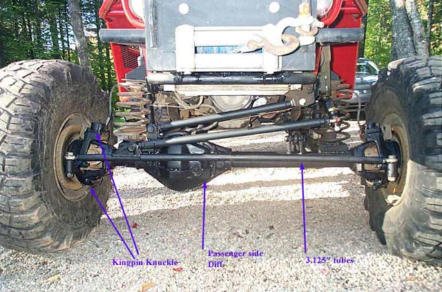

I will start with a dana 60 front axle
they came in all 73 to 87 1 ton 4x4 trucks(crew cabs till 1991)
they have king pins not ball joints look for a 4 bolt cover on top of the steering knuckle.
the pass side uses 1 u bolt and 2 studs to mount to the spring plate

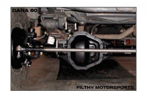

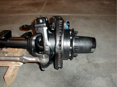

they have the same dana style cover as the smaller 44 but it is a lot bigger.
that should help identify a dana 60 front axle I know there are more ways but these are the easy ways for anyone to identify one at a glance.
