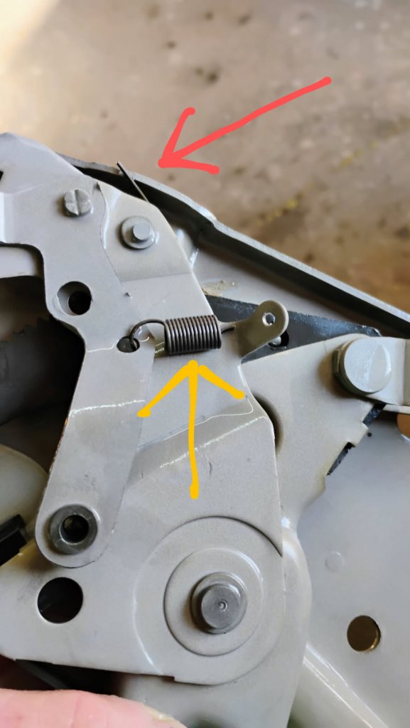

Hello, I've searched and haven't found an answer for this: In my pic there's a red arrow pointing to a spring that appears to be working, but the end sticking out doesn't look right, if I tuck it in with a screwdriver it goes back to the same position, is this normal? Also the spring with the yellow arrow has the end broke off and I can't find a replacement, anybody know where to get one? As a last resort I guess I can bend a new loop on it and reuse it. Thanks.

Is that not the parking brake switch for the brake indicator light?

Just had mine apart last night! Not sure about the spring in question, but I was able to find a replacement for the other at one of my more stocked hardware stores. As long as it it tight when installed and stretches the entirety of the travel you'll be fine.

Thanks, that's what I'll do on the broke one. On the other that's sticking out I guess I'll leave it alone since it was working, I just don't like knowing it's not right. It doesn't look like this can be took apart very easy.

I thought the same. It's all held together by some weird connector that is cross-slotted on both sides like a phillips head but I venture is actually stamped like the hood hinges. I'd say if it functions leave well enough alone!

Right, it prob left the factory that way, ha.
