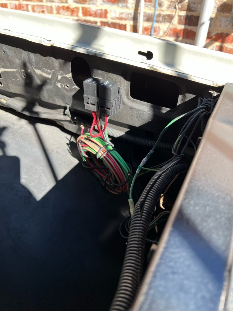

Randy De Oreo
Feb 6, 2021
514
456
North Richland Hills, Texas
Randy
C-10 LWB

I already have a relay box for under the hood so guess I'll wire them straight from that. Will have to eventually locate the trigger wires - most older cars I drove had a dual stepper relay for the headlamps - made grafting in HD wiring much easier. Amazing how crude and lacking the electrical system is in these. Makes me glad I gutted it. Some of the older cars I messed with had electrical diagrams that were 3 to 7 pages total (newer ones were 400pgs+). These weren't that much further ahead. lol
