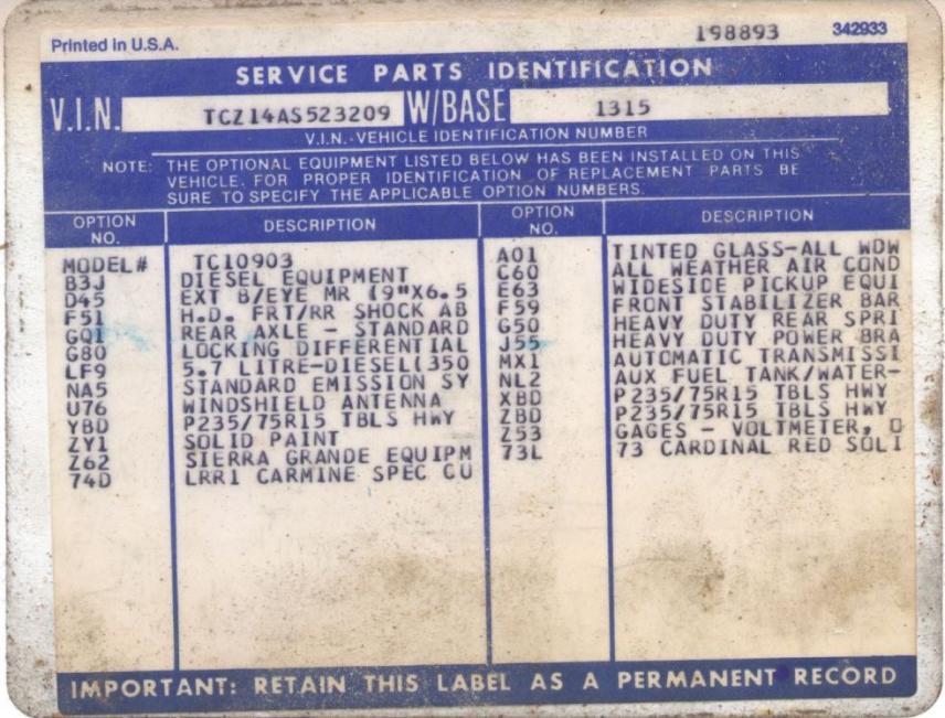

Yep, The 80 GMC 1/2 Ton 2WD I bought, RPO Code said, STANDARD RATIO, but didn't give the ratio. It turned out to be 2.73. Both 81s, the GMC and the Chery 1/2 ton 2wd trucks also both had 2.73, but the RPO Code didn't say Standard Ratio, is just gave the Ratio and the Code for 2.73. Sucked ass badly. Even friggin station wagons had 3.08's.

Maybe 80 was the first year for listing the ratio via RPO code. I'm almost 100% certain, 80 was the first year they installed the G80 Gov-Lock Bomb, so maybe the G80 RPO code went into play along with the RPO code for gear ratio all at the same time.
This is out of the 80 GMC I bought for $150 or $200, can't remember, but I sold the 12 bolt G80 Axle for $200 to a guy who swapped it into an 85 Peg Legger 2.73 truck 10bolt. He was tickled to **** to have a "Posi 12 bolt"

It was a 350 before someone swapped in a 454. IIRC, I found that the dealer brochure lists 4.56 as standard if equipped with 350 and Camper Special and 4x4. I think the 4.10 ratio would have been standard (with other options being the same) if it were ordered with the 400sbc.
Basically yes, it was a package in this case. But the ratio is not listed on the RPO sheet.
