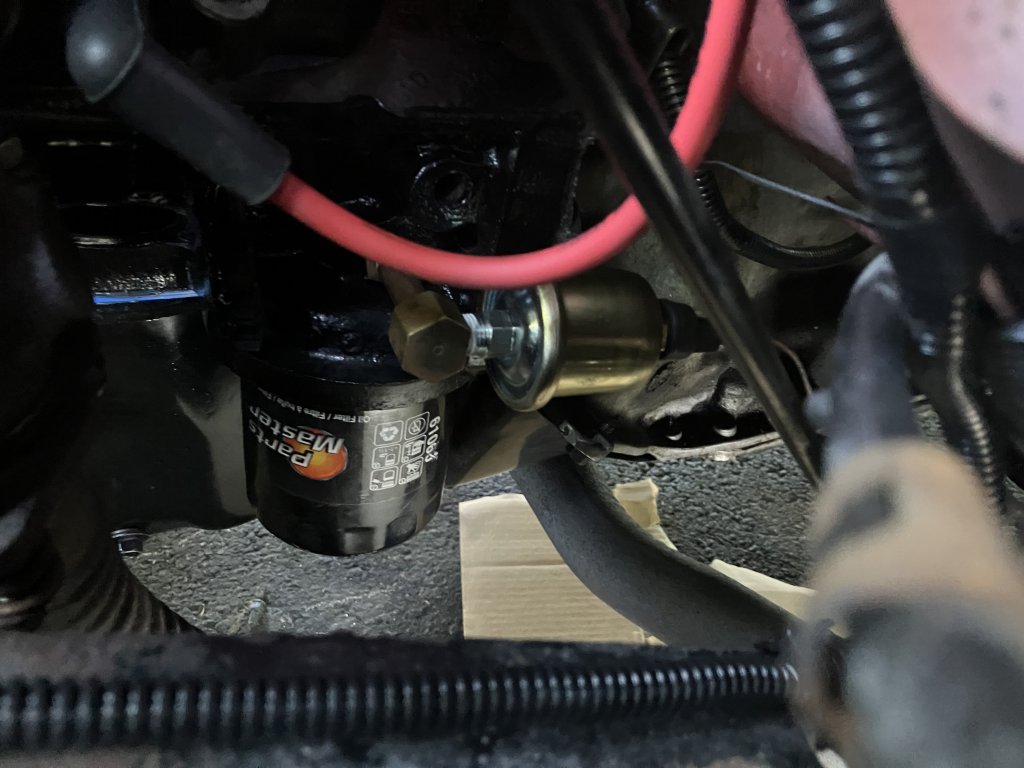

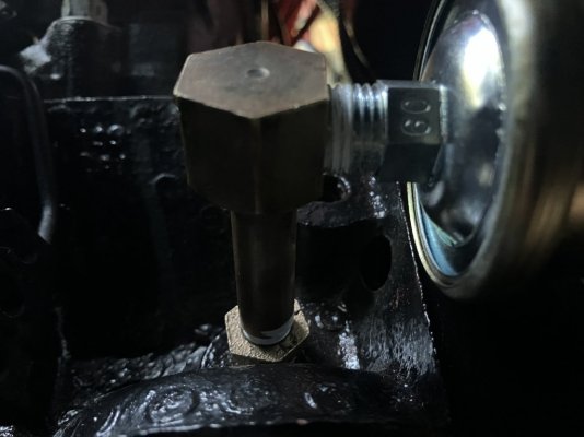

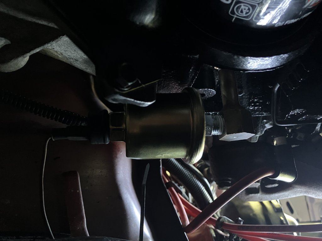

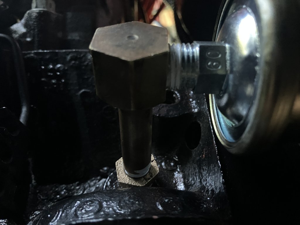

I swapped my 305 for a new 350. And relocated the oil pressure sensor from behind the distributor to above the oil filter.
FYI to plug the oil suppy hole behind the distributor you will need a 1/8 NPT plug, they can be had at any hardware store for 5$ or so.
To mount the sender to the side of the block I used a 3” ext with 90 deg port from a TBI motor and a 1/4 male to 1/8 female adapter.
Hope this is of use to someone.
