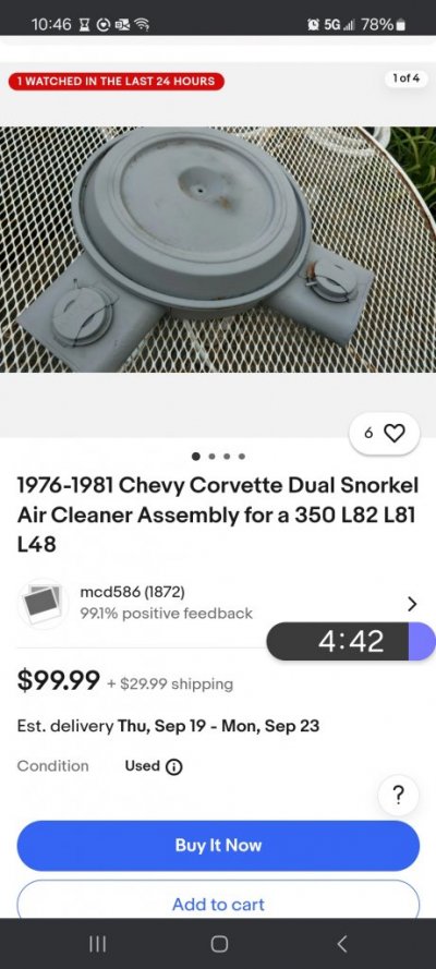

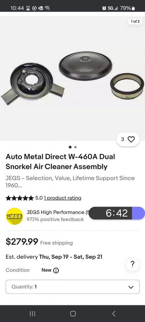

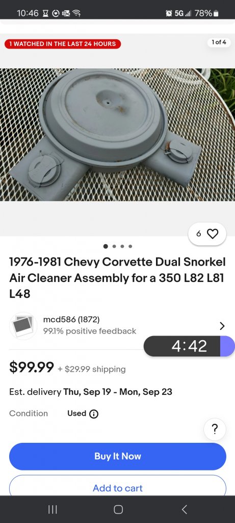

I can follow your thinking. Look on ebay etc. For an Air cleaner for an l69 305. They have dual cold air snorkels. Some other GM products had them also but can't tell you off hand which ones.
