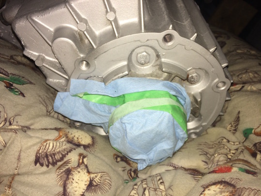

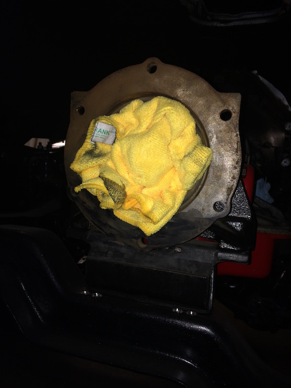

    Going to mate my NP208 transfer case up to my TH400. My question is, where they bolt up together, is it a dry connection? Or should I put some black RTV in-between where they meet up? I've attached 2 photo's to help you guys understand what it is that I am asking! Really appreciate the help!

    It's a dry connection. The transmission output seal and the t-case input seal are supposed to cover you from fluid leaks. I think there is a little paper gasket that you can buy, though, that goes in between the two... Yes, there is. I searched "NP208 to TH400 gasket" and found several options for sale.

    There should be a paper gasket on either side of the adapter. The input shaft seal on the transfer case prohibits fluid transfer.

    I also got an email back from Chris at ORD (Offroad Design) that gave some good insight to perhaps anyone else that could benefit from his response!
    This pertains to mating a TH400 transmission to a NP208 transfer case. And regarding the seals / gaskets for the adapter after the tailstock on the tranny, and after the adapter to the face of the transfer case.
    From Chris: "Gaskets aren't critical there, you can use them if you want but you don't have to. There are some applications that absolutely NEED to have the gaskets there (such as NP205's and some older 4 speed manual transmissions, etc.) But this (TH400 to NP208) isn't one of them.

    I find that amusing because the factory put gaskets there. And trans fluid lays in the tail housing and with out a gasket it will find its way out. Do what you want I will keep gaskets in there or the square o ring.
