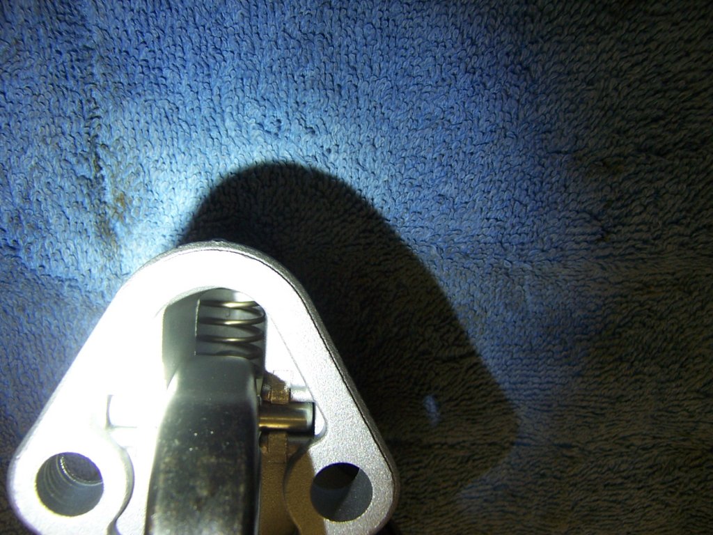

Read my previous post on fuel pumps.
Here's the spring that was missing on the first 2 failed pumps. Only replacement brands I found that had the spring were Delphi or AC.
