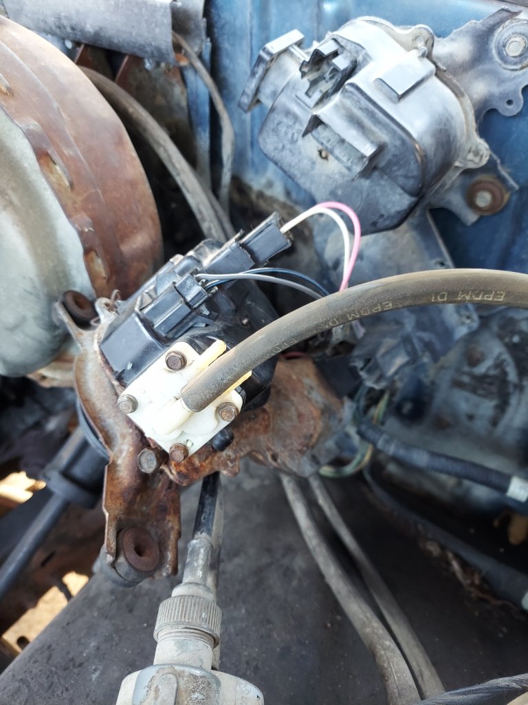

I cleaned the ground contact area with sand paper and still had nothing. So using a jump box I ran power directly to the washer and it worked. So I looked around and the wire going to the plug was barley hanging on. So a little disassembly of the plug i re attached the terminal and it now works. Also when I am under way the wipers work quite well as does the pump now. Thanks for all the help! For anyone wondering the plug is pictured below.
