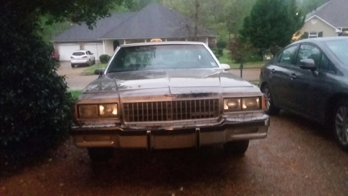

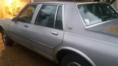

The Jetta has worn camshaft and lifters, there's something wrong with the throttle actuation, one of the fuel pumps is bad, the triptronic switch is bad (I don't think it's the trans, but it could be), there's some kind of electrical problem that comes and goes (BCM?) where like if you press the brakes, the window will go down, and the A/C's failed. I don't know if it's the freon because I tried to charge it, and it didn't work. I think it's the compressor. That's all I can think of, but there were a couple other things. Anyways, I got a couple pictures here of the Caprice. It was in much better shape when I was a kid, but I think I can restore it back to glory. The Jetta's nothing special to see, but then again I'm pretty disgusted with it.
