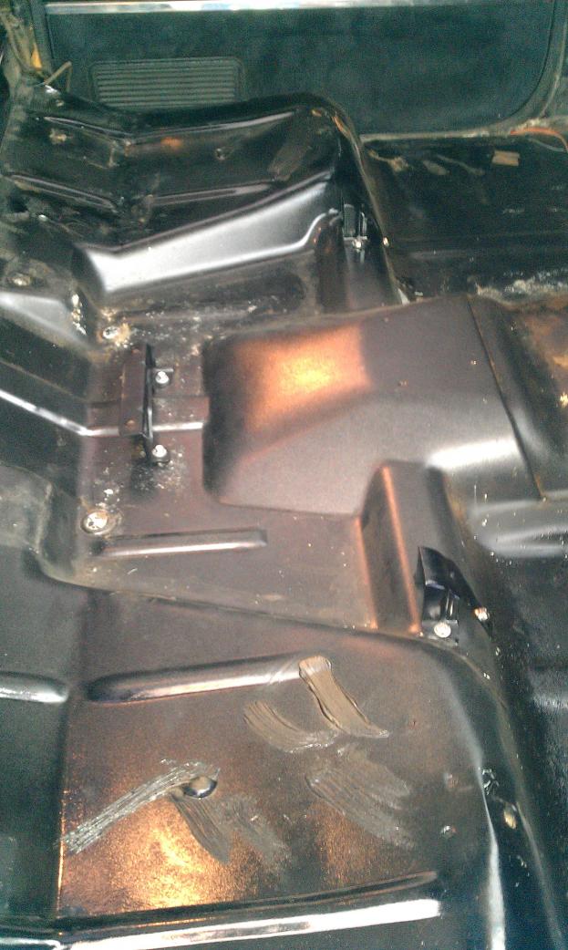

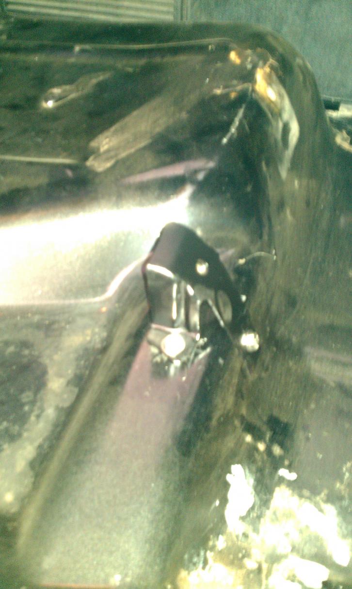

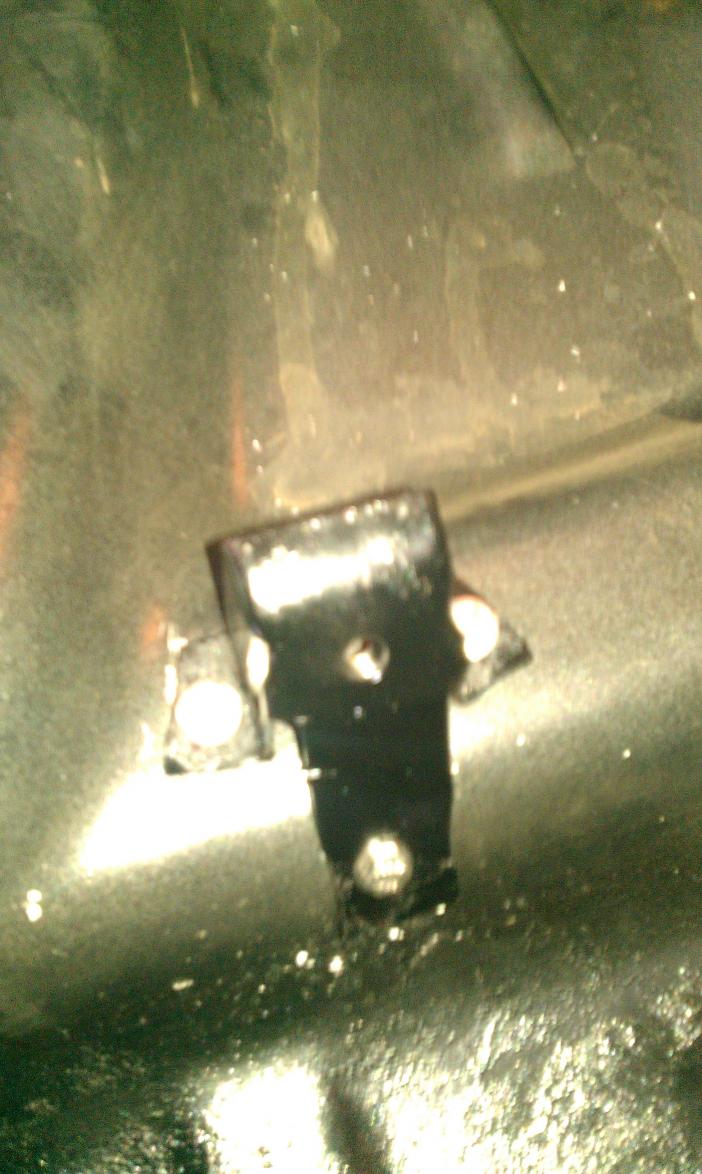

Here is my 82 reg cab floor with brackets installed for a comparison when you get a burb floor pic.
