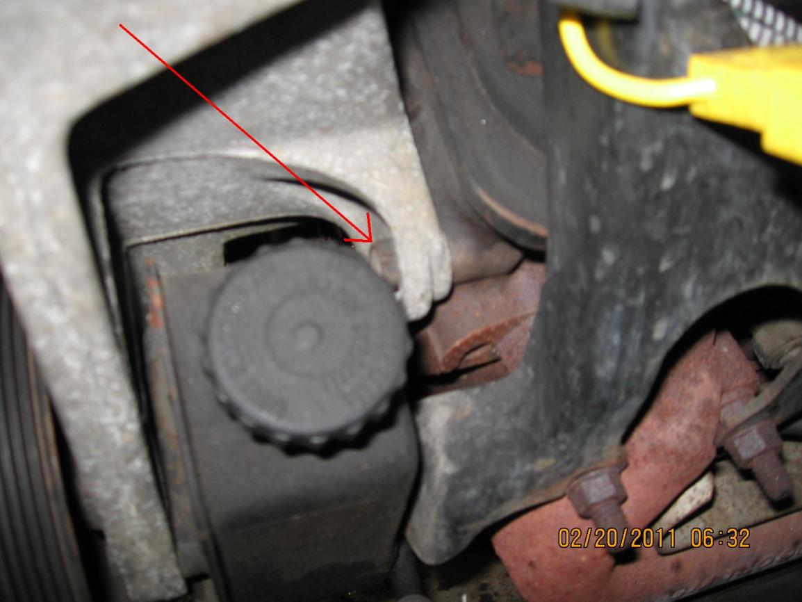

Did the power steering pump already mounted to the bracket? Was there a bolt behind the pump to mount the bracket, like this?
attachment.php
