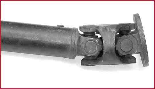

This is a double cardan joint it basically reduces the angle of the driveshaft by having extra pivot points, it'll still have the splined two piece driveshaft.
