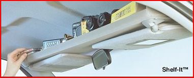

The 'shelf it' idea from LMC is kinda interesting.. I could probably build that.. and then put something up there, but i don't know how much room it really provides or if it becomes something that blocks vision at all.. Anyone used it?
