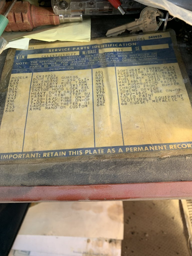

Newbie here looking for some input. 77 K10 SWB 350 4 spd all original owned since 1990. Stored under cover 24 years no climate control. Wanted advice on fluids, pre-start process, etc. Will be daily on our ranch & short trips to town once everything addressed. TIA

Have any more photos of the whole truck? I see some pretty cool and uncommon options on the SPID sheet.
Most notably the 16” tube type wheels and mandarin orange interior.
