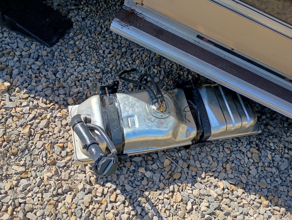

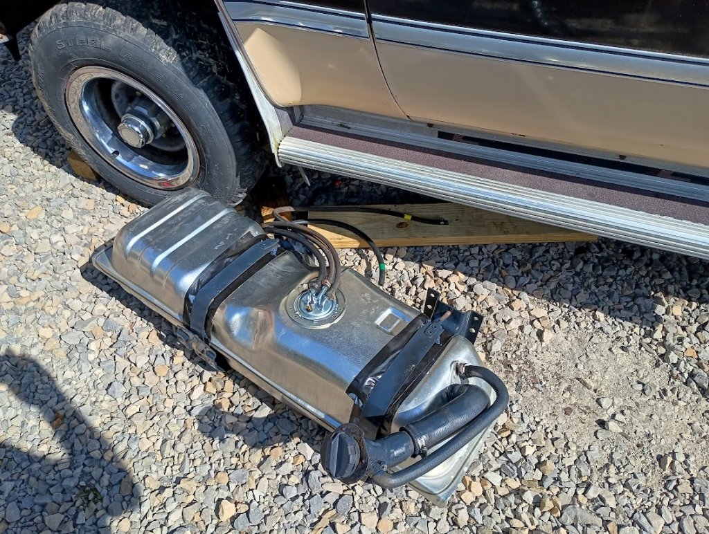

I replaced both tanks, fuel senders, hoses, and tank switch valve. I got everything from Rock Auto. Didn't need the straps. I didn't change the fuel pump. I just transferred them over. I did it myself in the driveway. Would have been a lot easier if someone could help you hold and fetch things.
