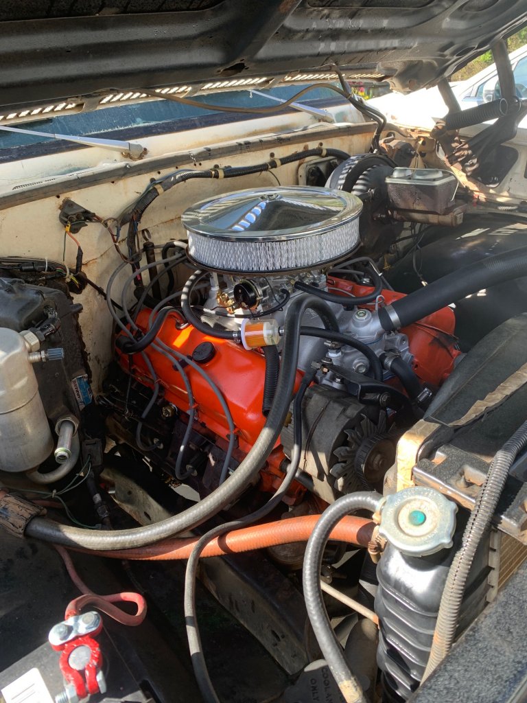

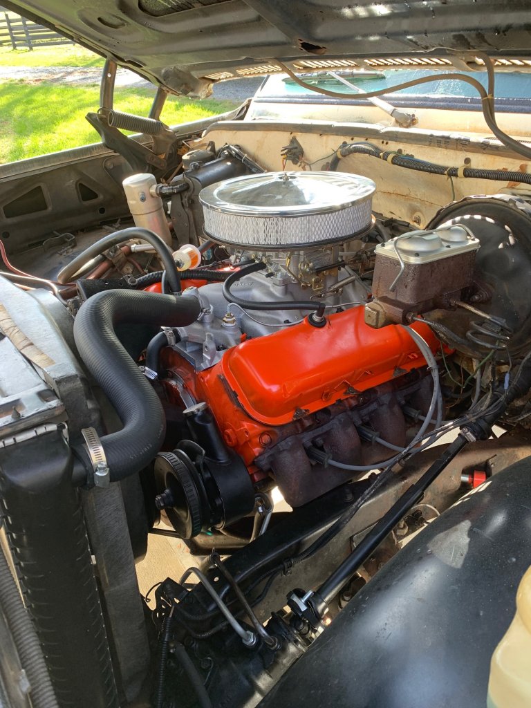

on my 73 K10 (454, TH350 and NP203), I am removing my 454 and installing a 305 from a '88 Camaro. The 305 is a one piece rear seal, roller cam and full serpentine system. Ditching the TBI for a small electric choke 4 barrel (prob 500 cfm range). Have been researching what I can use from the 454 and what I will need to get. Can you help me determine if I have researched this correctly or not? Thanks
New torque converter - 305 to TH350 probably 2200 stall range
the 305 has a flex plate installed (had a 700R4) - will reuse this
starter from the 454 is new, dual mount kind so I will reuse that
will use the HEI from the 454 but will swap out the drive gear from the small cap that was on the 305
the 305 has a mechanical fuel pump block off plate, need to determine if the factory roller cam has fuel pump lobe and if so, will reuse the fuel pump from the 454 but will get a Howards Composite push rod 94475
The 305 has steel motor mounts on each side, I think they will work but I may need to get different rubber mounts with going from BBC to SBC? (have read a lot of conflicting info on that)
Will change out the SAE power steering supply hose fitting from the 454 and use that in the power steering pump that is on the 305 (will have a metric fitting) - that way I can use the existing power steering hoses
Will use a alternator adapter fitting to use the CS130 alternator on the 305 (CS130 to 10SI I believe it is)
One of my big questions is with headers. I am looking at Summit SUM-G9006 long tube headers for the 305 and it sounds like they will fit the K10. Any concerns with this being a K10 and not a C10 with header fitment?
I would assume it is standard practice to remove the front clip with engine swaps in a K10? I dont think my standard cherry picker would handle the height.
Am I missing anything do you think?
Thanks in advance
