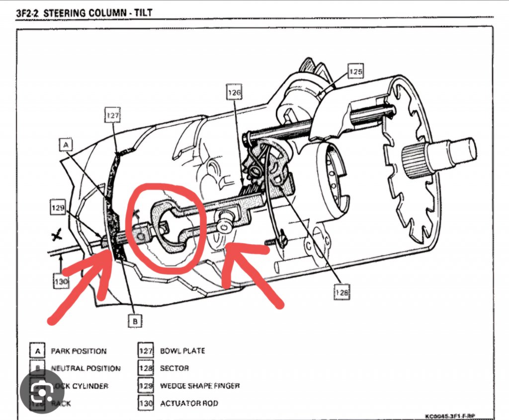

This should help you was trying to find a pic of a broken rack to explain some things,but couldn't. I did find this for you. https://www.steeringcolumnservices....tiac/GM-Rack-Gear-Replacment-Instructions.php
What I wanted to explain was if the rack is cracked on one leg it will open the crack when you go to crank position due to spring pressure in the switch. If the rack is cracked you may buy some time by using your column only for on and off and using a push button switch to engage the starter. We'll I guess I forgot to hit the post reply button a couple of days ago. Sorry
