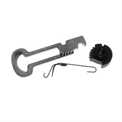

The racks are known to crack and cause exactly the problem your having. If adjustment doesn’t solve the problem, you probably need to dig back into the column. Get it fixed before it breaks completely and the truck won’t start.
This is what the rack looks like. The aluminum part cracks and takes more travel to move the ignition switch. Every time you turn the key, the crack gets a little bigger until it won’t start.

True, but the OPs is a non tilt, so FYI it looks a bit different.
Link/pic below.
