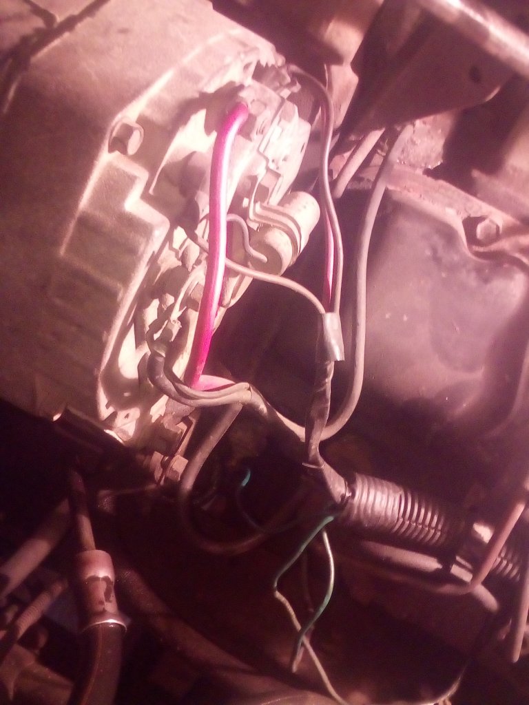

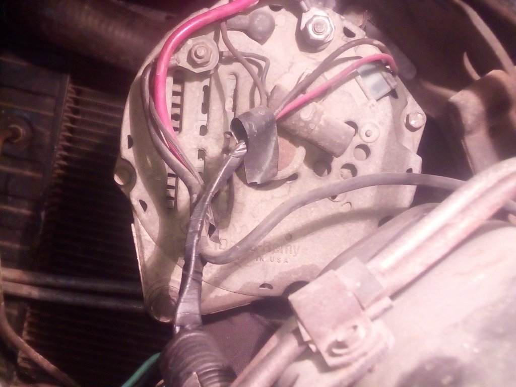

Τhanks a lot for your replies. To get a signal from the alternator, from which point of the alternator should I get that signal? My alternators look as at the attached photos. Thank you.

From which point at the housing? From the positive output terminal, from the Terminal 1, or from the Terminal 2?

It's usually an AC tap from one of the phases before the "triode." You'd be best off consulting and alternator rebuilder to see if they can add a terminal for you.
