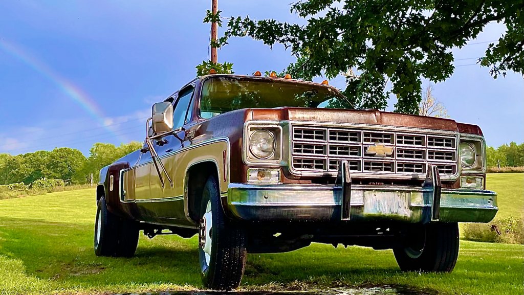

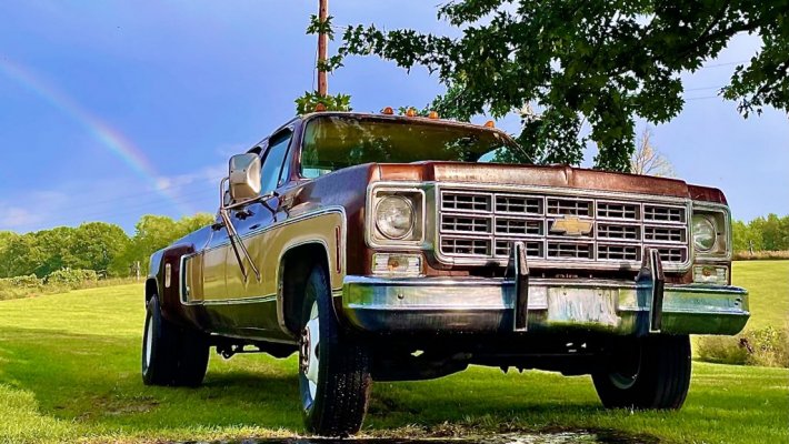

Finally found a square body form, here are some of my projects I’m playing with.

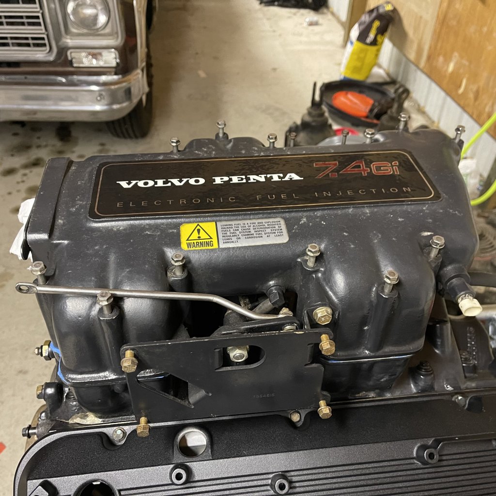

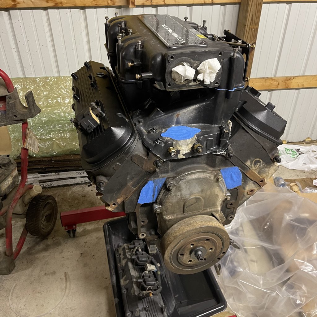

So I was looking for a long runner EFI intake for a big block, come to find the only place that did anything direct port injection was boat stuff. The 7.4 Volvo Penta is basically a rebadged Gen6 long block with everything mounted to it, fuel pump, surge tank, ECU everything in one package.

This is a kinda kit-bash of an engine build, the block is a Gen6 GM crate motor I got from an engine shop with only one year in a Suburban before the owner wanted something bigger, the intake is from a Boat for the long runners, just got a GM cam position pickup and 58x tooth crank pickup, removed the distributor and use a oil pump drive from a 4.3 vortec V6. It’s more of a science experiment.
