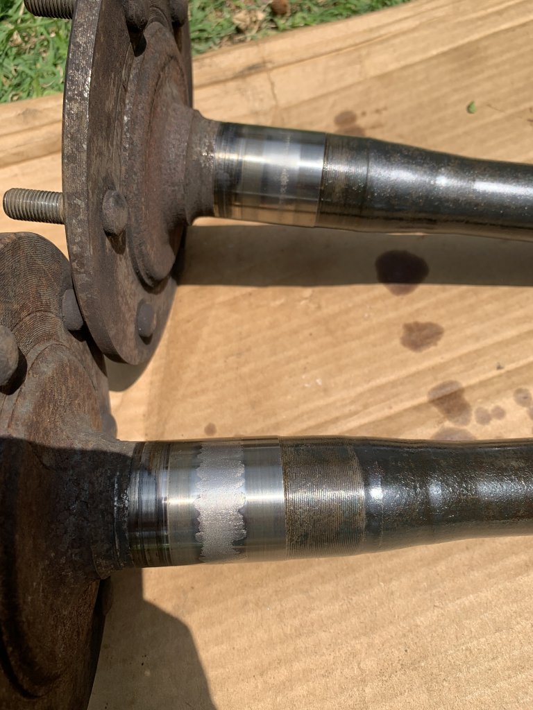

Need your experienced advice. 1986 k10 rear axle
are the axle shafts shot?

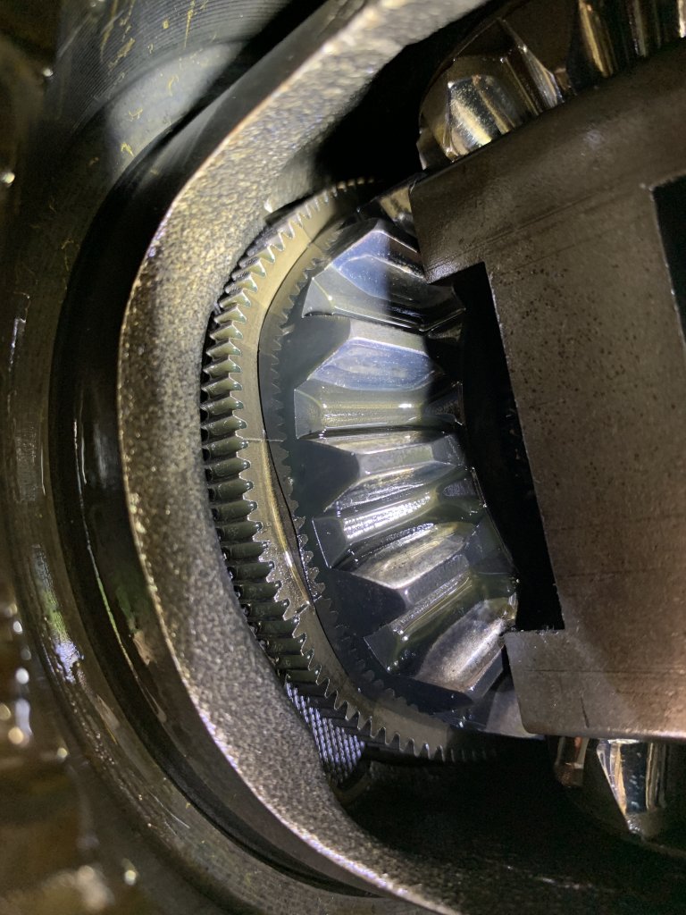

Is the carrier cam gear broken?

You can get by with the shafts. Not for very long though. Will need to do bearings and shafts. I'd say no more than 10,000 miles for sure. BUT if the rest of the diff is good still, I would recommend changing as soon as possible before your diff is bathed in metal shavings and takes it all out.
I can't speak on the small gear teeth. Does kind of looked cracked and distorted. But again I don't know what it should look like .

Here's a bad one and a nearly there bad one.

Thanks, that’s helpful. I was doing bearings when I found the other issues. I tend to long term fixes rather than short. So I guess new shafts it’ll be.
I think I found a picture of the Eaton gov lok cam gear. It should be flat and mine is definitely not flat. So, I guess a new carrier it is too.
Are Yukon 1541 shafts and Eaton Detroit locker good selections?

The cam gear looks ok to me? Those appear to be lines in the casting. It also looks flat, after inspecting the photo for a bit. The waffering on the backside of the side gear made it look like of those goofy carnival mirrors at first.

It is definitely not flat. I felt it. But sounds like you’re confirming it should be flat?
If our definition if "flat" is the same in this case. It should be round with no runout.
