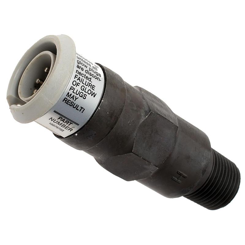

If it's an original '82 he's going to have the earlier style controller/sensor with the divorced relay.
I have a couple of these kicking around if you need one.

That's the one I got from the website entering the year, make n model etc....
The controller "works" yes, but not well, so it could be related to the temperature sensor? I always thought the GPs cycle as part of the ignition process. Then again, if I stop and get fuel, and start it up. There is no GP cycle. So yeah woukd make sense the temperature sensor comes into play.
Down the rabbit hole we go.
I found a video woth where the GP controller is. Buddy was saying you have to drop a bit of coolant from the radiator or have a coolant shower lol.
Yes the controller looks like what @Blue Ox has in his post.
