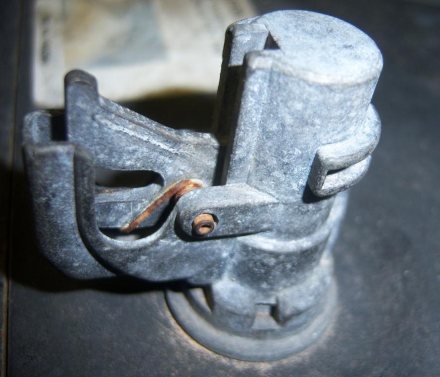

Step #2. Now that the latch is in the CLOSED latched position, using a pick or small screwdriver, push down on the locking tab inside the mechanisn through the hole closest to the glove compartment door on the passenger side of the assembly picture below. Keep in mind, if you can not see the tab to be depressed, its because you don't have the latch in the closed position. This is why you close the latch so the tab is expsed thru the small hole.

This is what the actual tab you are looking for to depress will look like inside the assembly.

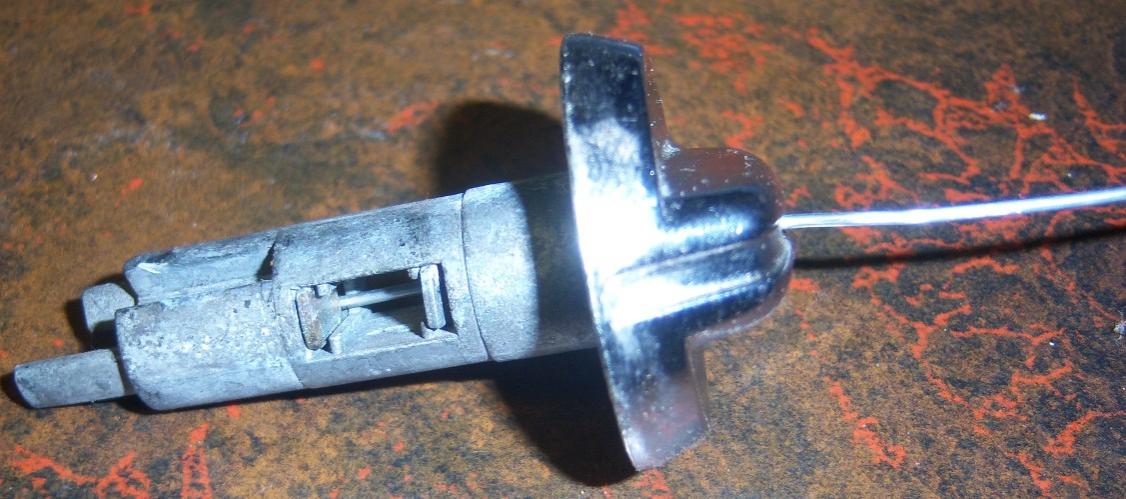

Step #3 Now put the paperclip into the hole in the front of the knob. This holds the tab in the depressed position and you should be able to now remove the pick form the assembly. Check to be sure though. This is why the bigger paper clip works better. REMEMBER, DO NOT PRY ON THE GLOVE BOX KNOB !!!

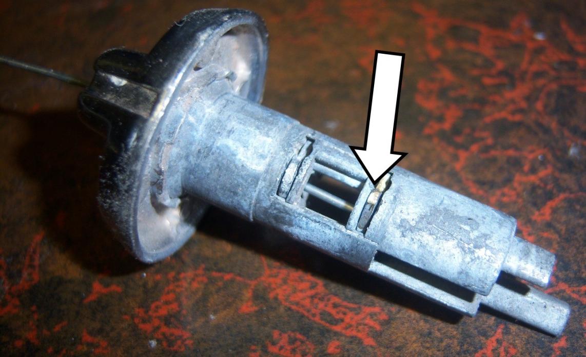

Step #4 Once the paperclip is in place to hold the tab, you can pull the pick out and in the larger rectangular hole toward the end of the latch assembly, insert the pick and gently pry the tumbler piece outward. The knob at this point will start coming out of the glove box door, but then you feel another stop and you will stop. DO NOT PRY any further at that point. You have hit the 2nd Tab.

Here is what the 2nd tab will look like inside the assembly.

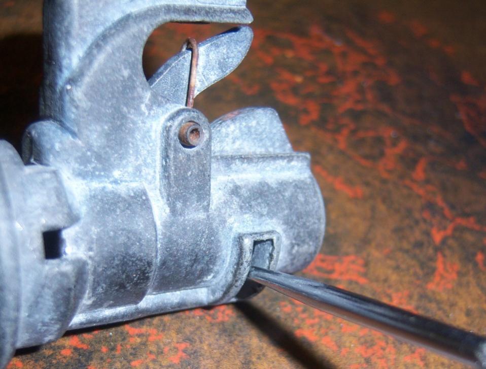

Step #5. Now that the 2nd Tab is the same location as the first tab you depressed, go back to the same hole with the pick and push in the 2nd tab with the pick.
