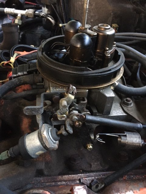

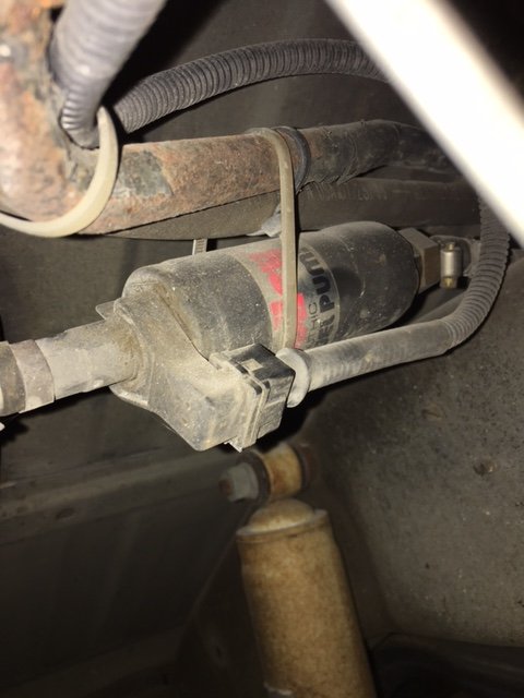

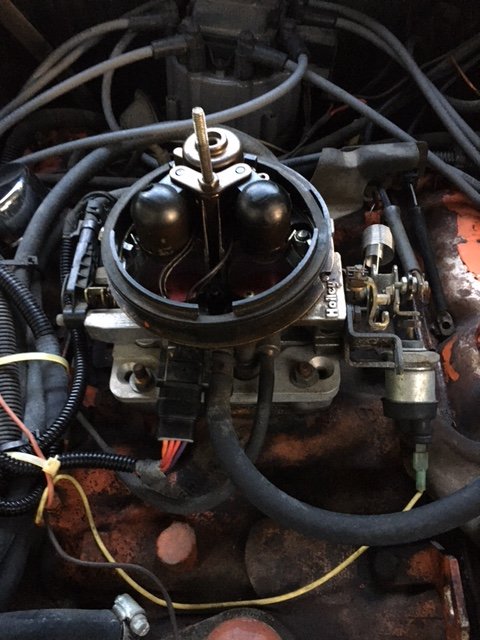

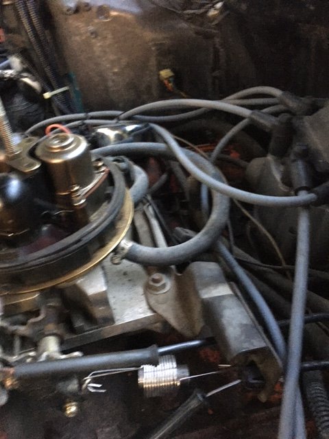

Just bought my first square body. Its a 1976 C20 burb 454. Its a beautiful truck with extremely little body and frame rust. The previous owner did a tbi conversion. Long story short the truck does not like to idle, wants to bog down when given above 50% throttle, and seems to be running extremely rich. I would like to convert it back to a carbureted setup but am completely new to carbureted world. I have done some searches but most of the resources seem to be for conversion from carb to tbi. My questions to start would be: what parts needed to convert to carb system and what resources would be best to have a little guidance through the build? I attached some pics of the truck and fuel system.

I cant see the intake very well,if its a 4 barrel intake you can keep that,if not,buy an intake and a carb.fuel pump,you can keep what you have and buy a regulator to keep the psi down around 5 psi or buy a stock engine mounted pump and not worry about it.im assuming this setup has a computer and a computer controlled distributor.if it does,buy a 4 pin distributor for a 76 or so model truck,that will make life easier

Looks like an old Holley ProJection 2 conversion setup. I don't think they were known for great reliability and driveability.
It also looks like a standard HEI distributor with vacuum advance.

If they left the old ‘76 vintage 4 barrel manifold in place, and it’s still a standard HEI, converting back should be straightforward, but will still cost a bit.
- get fuel pressure down to about 5 psi (tbi runs at about 58) . It looks like they just added an external electric pump. You could try to regulate that pressure down, but pressure regulators aren’t cheap. I would reinstall a stock mechanical pump and lines, and just go back to stock setup. If your fuel tank has 3 ports on the sending unit, ensure you get a fuel pump with a return line. In hot weather you need the tank return to cool the fuel and prevent vapor lock.
- install a carburetor . Edelbrock AVS2 with electric choke gets high marks for simple tuning. You may need to use a square bore to spread bore adapter if you still have a stock Quadrajet spread-bore intake. Quadrajets also work well, but quality and condition is unpredictable for old carburetors. Quadrajet is also more complicated to tune than the AVS2.
Holley carbs also work fine, and some really love how you can tweak them for max performance; however, it sounds like you just want it a little simpler.
- verify operation of the HEI. Set base timing to about 10-12 BTDC, and verify you get 18-20 more from mechanical by about 2500 rpm before connecting the vacuum advance. Connect vacuum advance to full vacuum on the carburetor and look for 15- 20 degrees vacuum advance.
- for a big block you might need a tuning kit or one of the higher cfm carburetors to get best power. Most of the off-the-shelf carburetors are about 600-650 cfm, and are tuned for economy on a 350 cu in engine.

Thanks for the replies guys. So of the two main choices I could either keep the line with the electric fuel pump and just add a regulator in series correct? Or I could replace that electric fuel pump and line with stock line and run a mechanical fuel pump and extra line going from pump to carb?
To me it would make more sense to run a mechanical setup but it does seem simpler to just add a regulator in series if that's all that would be needed. Also how can I be sure that the stock camshaft is in the motor that has the mechanical fuel pump provision?

Guys does that look like the TV cable is disconnected? Surgeon, I didn't even think about that fuel pump lobe on the cam not being there. But whoever did the conversion probably just put a block off plate on the engine. I would really check it out closely to make sure you could even get a regulator for pressures that high that would turn down that low, 5-6 psi! Some regulators that go down that low won't go up that high. They aren't all universal, they are specific for a certain range of pressures low to high. That's why I would ask about the range of any regulator you were looking at.
Or take that thing, the pump, off and get you a good brand mechanical fuel pump. Even the factory fuel pump for the 454 would be okay if you're just doing this for a daily driver, which I would suppose you are. It would be well in the correct range and would be cheaper than racing after market pumps. And easier to install.
