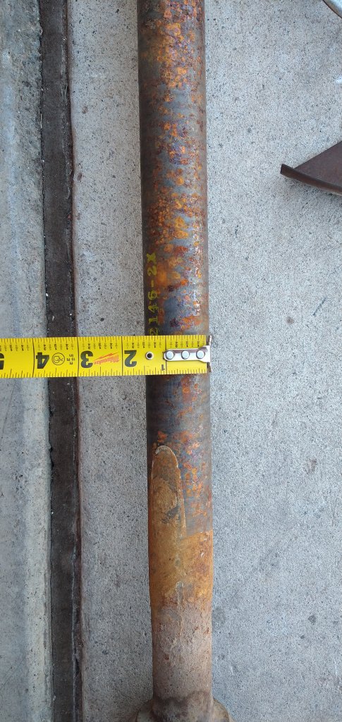

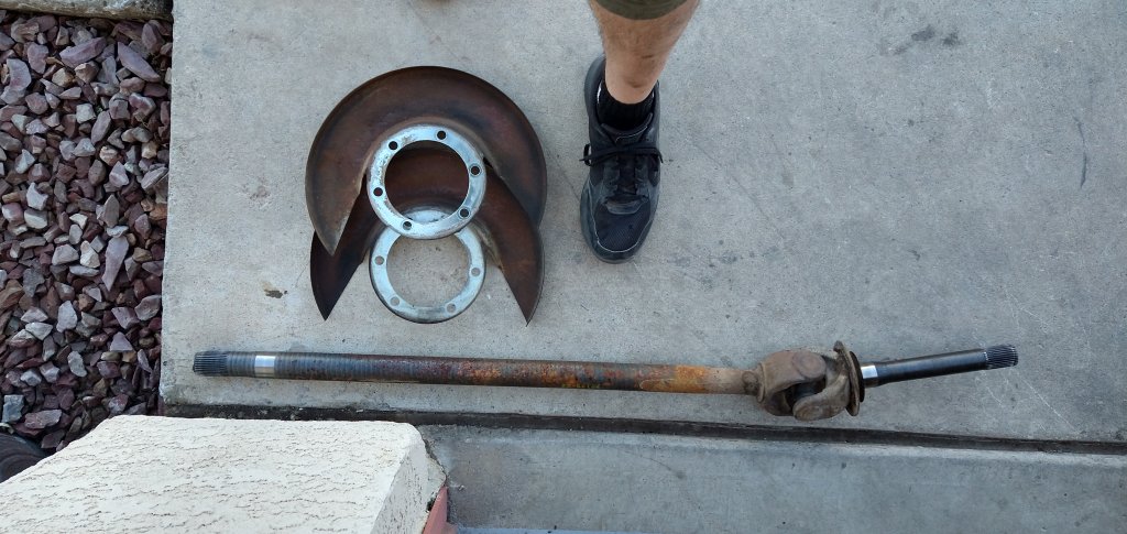

Had a slight clunking issue with the front diff. Only noticeable under 5 mph when turning. Pulled the hub today and discovered the inner spindle nut was about 3/4 turn from being snug. Both sides. Blame it in the young soldier who serviced it many years ago. FYI, I pulled the axles from a CUCV.
Anyway, it got me thinking because I pulled everything apart just to see how it works. First thought was, "my God, those axle shafts are gynormous"! They must be an inch and a half in diameter. I noticed the u-joints between the inner & outer shaft have no zerk fitting? The joint feels tight with zero play.
This got me thinking and I'm looking for confirmation on this: If you have a part time T-case and lockout hubs then the shaft (and u-joint) ONLY turn when in 4wd, correct? If so, I would assume there are a lot of trucks out there where the front diff has virtually no miles on it compared to the rear. If you never drive in 4wd, the only wear on the front axle (not counting suspension and steering) are the wheel bearings.
What say y'all?
