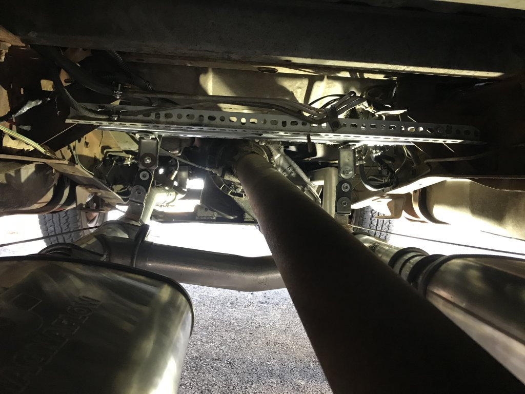

This is a picture of the duals on my ‘75 K25 with an NP203 (during installation, so all pipes are not yet tightened), which may be the same chassis as your truck. Not sure about your cross member design.
Look at all the pipe clearance next to the transfer case on the driver’s side, and then look how tight it is on the passenger side. It was challenging to get that pipe centered and not have it rest against the transfer case, or bang on the crossmember over bumps.

that is true, an np203 for sure leaves little room. I cant wait to see what his setup looks like
