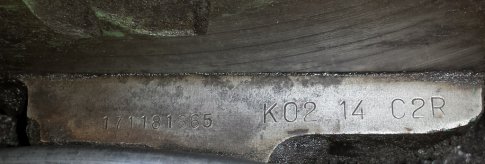

So I recently aquired my ole '74 and started doing some work on it. Then I decided to start cleaning up the sludge that entailed on the block. From there I decided to start identifying this sucker.
So the first place I looked at was the pad in front of the right head and this resulted in this find:
171181665 K0214 C2R
Now I realize the majority of that doesn't really mean much but the C2R on the end means its possibly a 305 block. So I started doing more reading on ways you can figure out better what you have for an engine.
171181665 K0214 C2R
