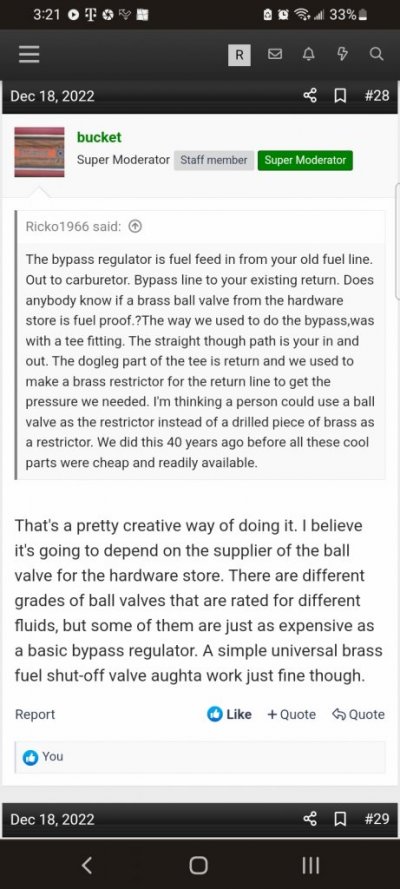

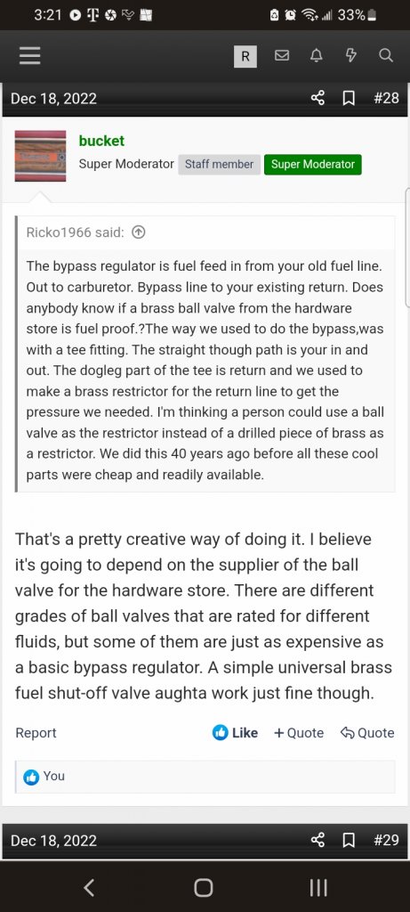

Well, I do'nt claim any certifications, or any superior knowledge. However, every time vapor lock happened to me back in the day, I'd put a "T" fitting on the carb inlet, and a smaller line coming back to the return line to the tank. It acted like it's own pressure regulator of sorts, and always had fresh fuel flowing to the carb. Another trick was a phenolic, or whatver material it was carb spacer, 1 or 2 inches under the carb helped as well. That usually solved any issues. This was something used in the desert in El Paso Texas.
Again, I am no expert, y'all can bake me and my stupid answers all ya want, but that did seem to work with plain old mechanical fuel pumps...
This will truly make it a bypass regulator.
