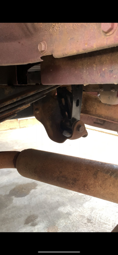

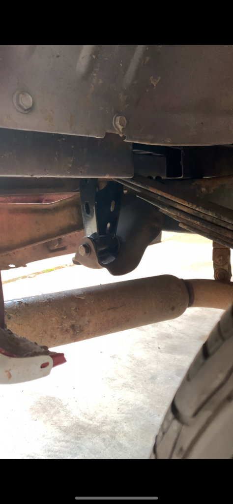

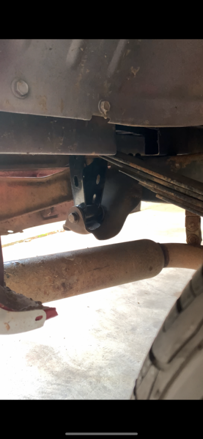

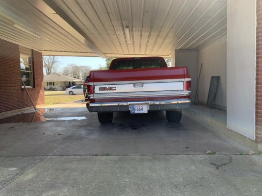

Hello all! First time poster, long time follower. I have a 1985 C-15 that I decided to lower one step at a time. From factory ride height, I decided to install a set of 2 inch drop spindles to level the truck. This was the first issue. The spindles got close, but didn’t lower the rear a full 2 inches. But it got me within a half inch of the front so I was happy enough. Then I decided to grab a set of 2 inch drop coils and a set of 2 inch drop hangers. Both went in with no issues, but when I removed the jack stands I noticed that the front was about an inch and a half lower than the back. The truck is also about a half inch higher on the passenger side. Below are exact measurements from the ground to the wheel wells:
Front left 28 3/8 Front right 28 7/8
Back left 29 7/8 Back right 30 5/8
I am attaching pics of the hangers and shackles to show correct installation. I did notch the bed support and have plenty of clearance there.
Pictures 1-4 are of the new shackles and hangers.
Picture 5 is of the current stance from the side.
Please help!! She’s too sexy to be this unlevel!!
