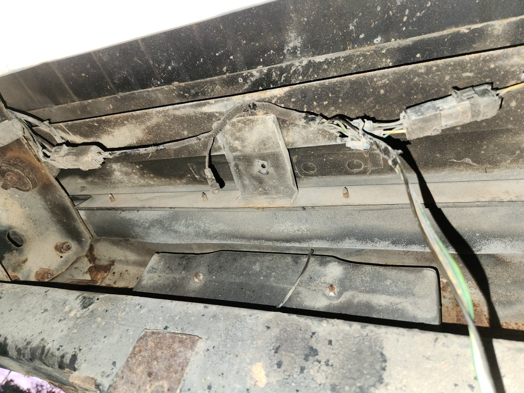

My driver side brake light does not work but I'm getting like 6.65 volts to the socket I followed the harness all the way down the body and no breaks in the wire that I can find im getting no voltage to this plug when I hook my dmm to it my hazard works on my passenger
side but not on the driver side turn signals do not work atm i get some voltage from the plug under the hood but only when the trucks on im scratching my head

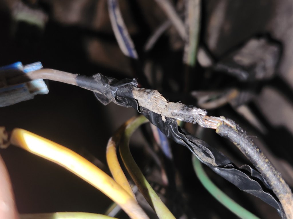

If the battery shows 12 volts, and your getting 6.65 at the socket I would verify proper grounds first. Then I would check the fusible link that looks like it was burnt and taped over, between the red wire and the junction on the firewall. One more popular cause of lighting issues is trailer plugs/wiring.

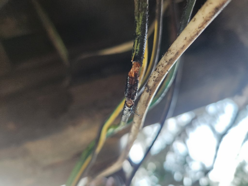

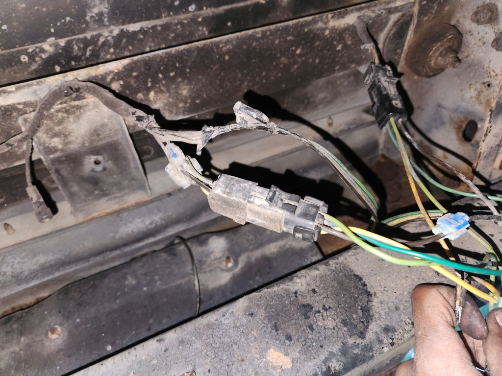

So i went and looked at the trailer harnesses and what i found was a mess looked like two plugs used by both taillights plugs connected to the harnesses plug i took of the two plugs and connected it to the main plug going down the path of the body nothing yet skeeters ran me inside before i could take batter pics

this is how I currently have them plugged in
