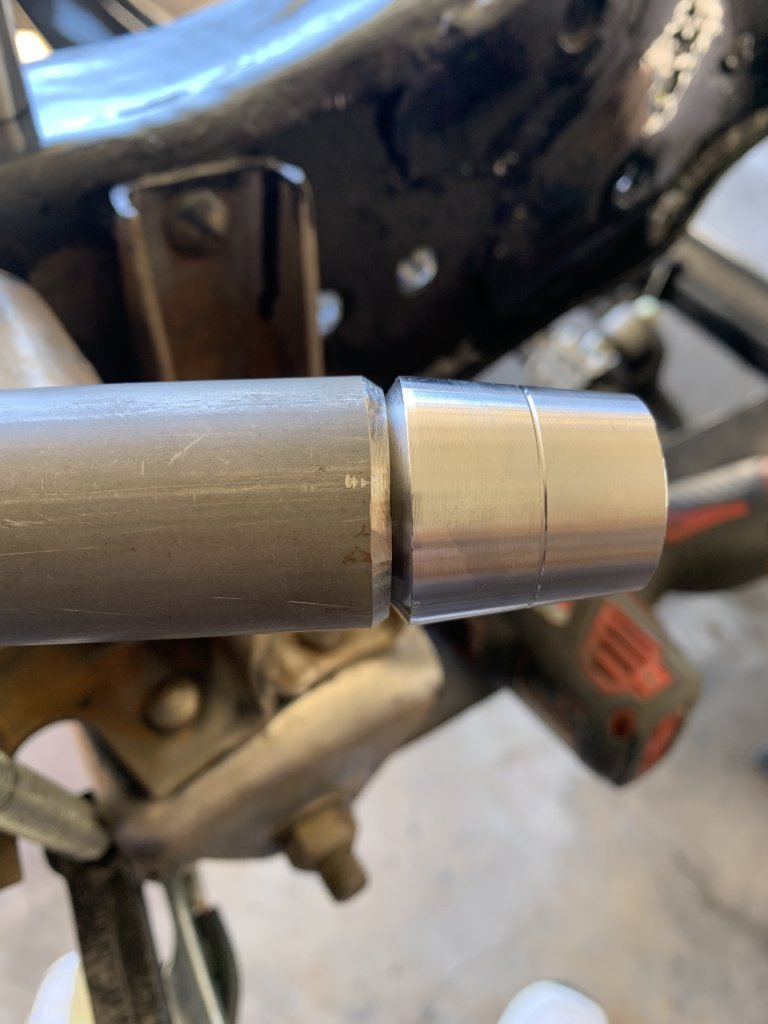

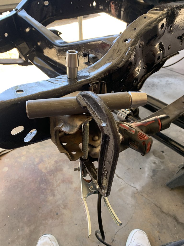

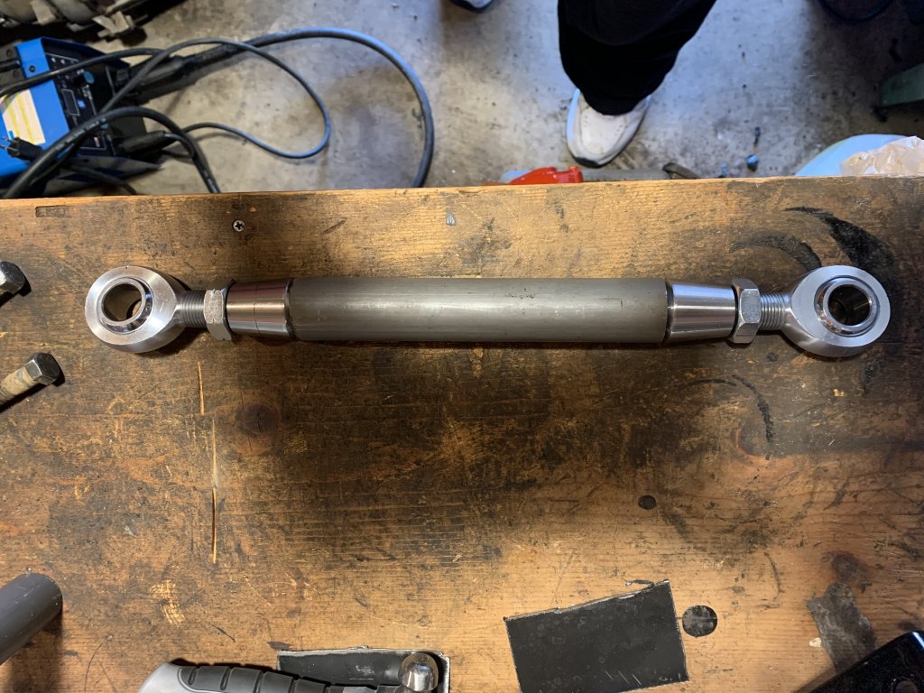

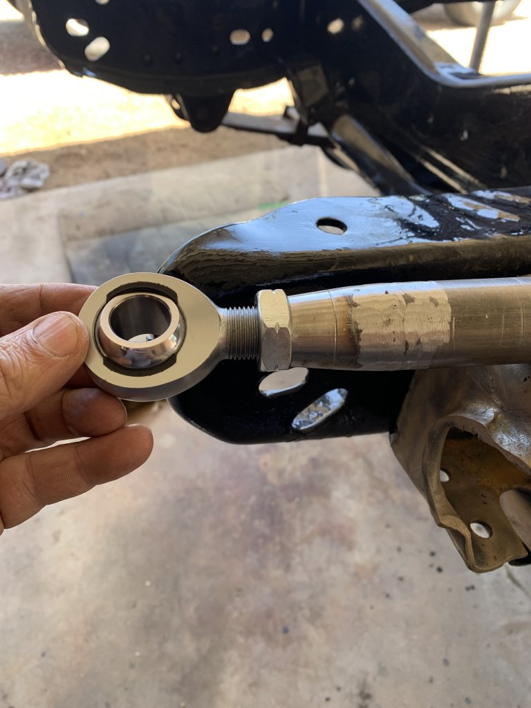

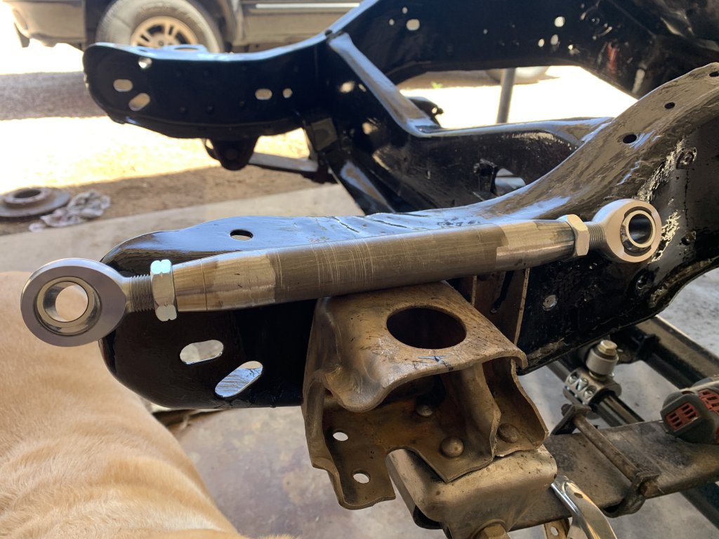

So about a month ago I posted a string here about a drag link. This is a modern option to the clunky Chevy design on all Squarebodys. Well, did some thinking, came up with a design, and ordered parts from RuffStuff. I now have a functional NEW drag link that will work with my 78 Scottsdale 4x4. This is DOM tube with left - right tube ends welded together. I then put in 7/8 HEIM joints. The pics show my steps, which aren't really that many....but it gets me the 15.5 inches of device that once was in there. The spacers aren't shown in the pic, but this guy should be able to articulate really well and make the steering very solid. Heims don't last as long as ball joints but the ease of replacement makes this just too easy to do....cheap too! Now time to clean it up, sand, and powder coat. Patent pending #752857841155689

No offense but that seems like a fair amount of work and money without actually improving the steering. You still have a super short drag link (compared to crossover ) so no added leverage on the system and the same old bump steer problems.
If you really want to improve to steering action/effort and reduce the stress on the frame then crossover is the answer.

I'm not sure what the gripe is here. We were all interested in talking about it... but it just wasn't what you wanted to hear. What you have done is simply waste time and money on something that is not the least bit stronger than the factory parts and they will wear out much quicker than the factory parts. There is nothing "better" or "modern" about heim joints for this application. But they look fancy and maybe that's what is most important to you. But from a reliability standpoint, this is not something that should be done by anyone that uses their truck often.

I agree with crossover, except I only have a 2 inch lift. ORD, WFO and everything I've read say you need more lift. SO, we stay with drag link. As for the expense, dom tube was 7 bucks, HEIM 35, coupler 11. So no, not expensive and it was a good time designing and researching the needs for this.

You may not have spent $500 or even $100 but you simply haven’t improved the part. The heims are not sealed so, as stated, they will wear faster than a typical drag link end. This actually creates more work and maintenance.
Crossover can be done with about 2” of lift, you she research how.
