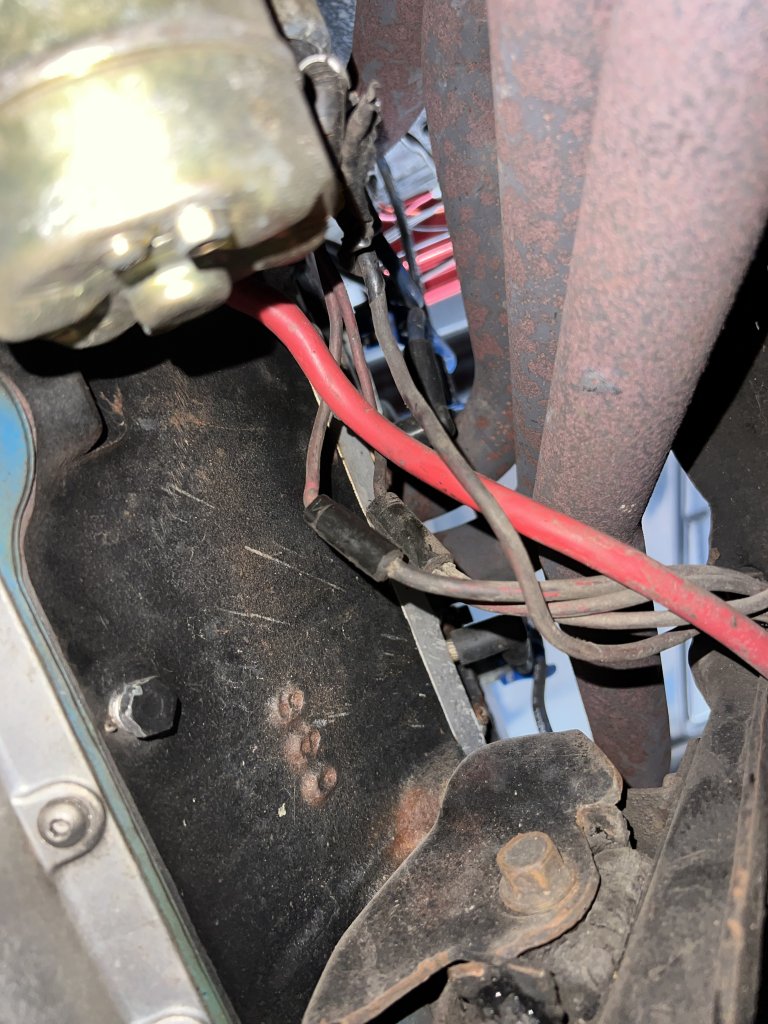

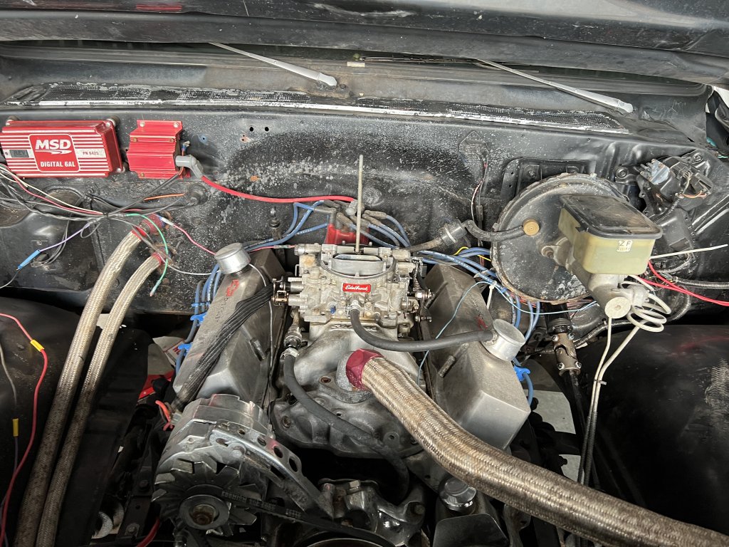

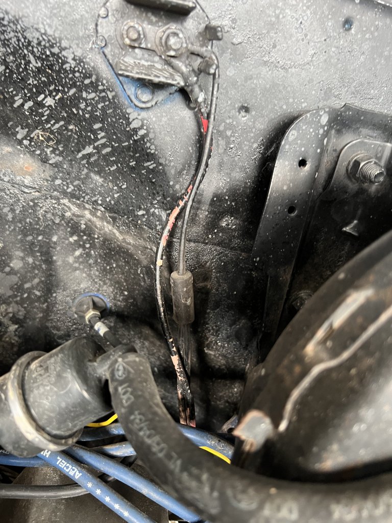

Crank, no start and no power to the gauge cluster makes me think you have a blown fusible link. You have two wires coming off your starter with fusible links and one coming off the lug on the firewall above the brake booster that also has a fusible link. One wire on the starter is for Batt power and one is for ignition power. They power different circuits in the fuse block. This is the most likely way to get a vehicle that cranks but wont fire, since the ignition coil isn't getting power. Climb under the truck and make sure you don't have a loose/disconnected wire at the starter or a swollen/blown fusible link on one of them.

Thank you very much for the reply. So I’m very new electrical work on trucks so please be patience with me. So I got under my truck and believe I found the fuses. Not to sure how they look but I was able to find something close to it online. My question is how do I know if they are blown? Is it possible to check it with a meter? With your input it makes perfect sense because my truck ran great. So it’s very weird how it won’t start now. I believe I found the other fuse around the brake booster. I attached photos. Also there isn’t no fuse I can check under the steering wheel?
