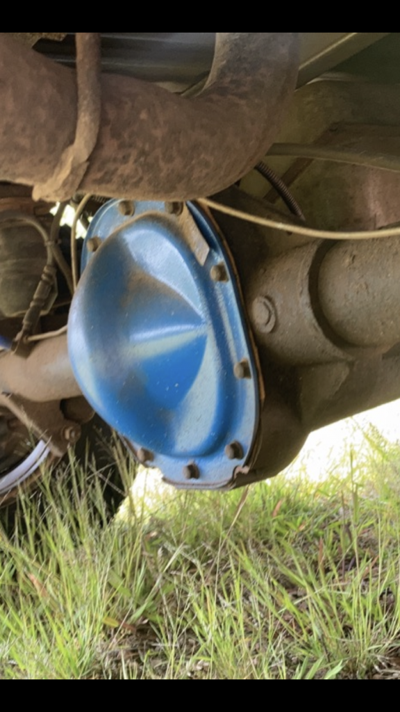

I bought a Riddler protective differential cover for my front axle to match my rear axle. I saw on the packaging as a benefit it said "additional fluid capacity". The cover itself is physically about the same size as the stock one. Before I replaced it I measured from the fill port on the stock one to the ground. 14.5"
The new one is 16.5"
I sat and thought about this way longer than I probably should have. How much should I fill it?
The owners manual for my truck says 2.125 quarts. BUT- this was before I added the Trutrac differential. This would displace more volume. So instead of volume I figured the important thing is fill height. I measured up 14.5" and made a small mark on the new differential cover.
So I added 2.125 quarts and let it settle. I then bent a zip tie to use as a dip stick. The level was lower than my mark. I added a total 2.4 quarts and the level is now 1/8'? 1/4"? higher than my mark.
I thought that was good- but wanted to throw this out there to you guys.
Stay with that? Or keep filling (it would be 1.75") of more gear oil. That would probably be 3 quarts? 3.5 quarts?
I have heard that overfilling will cause you to lose fluid out your differential vent or it will blow out your axle seals. Have no idea if there is truth to that.
What determined where the factory put the fill port? Needed to be high enough for the ring gear to fling oil around but not so much that it was swimming and created too much drag? And more drag in the fluid would mean maybe more heat? (completely guessing here).
Thoughts?
The stock location is kinda inline with the bottom of the axle tubes.
The new cover fill is closer to the top of the axle tube.
