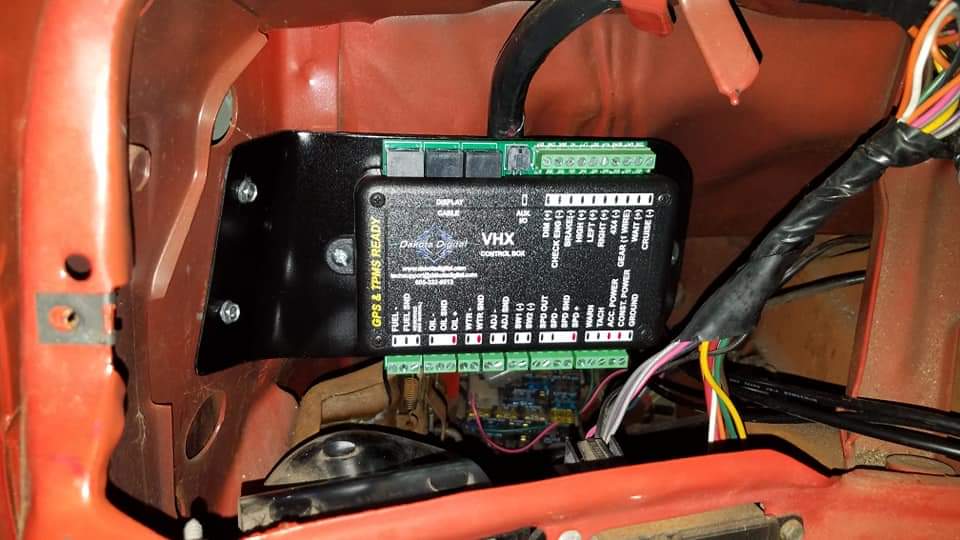

@wlwarnke has the RTX box mounted behind the gauge cluster on a custom bracket, there's a picture somewhere on here but I cant find it.

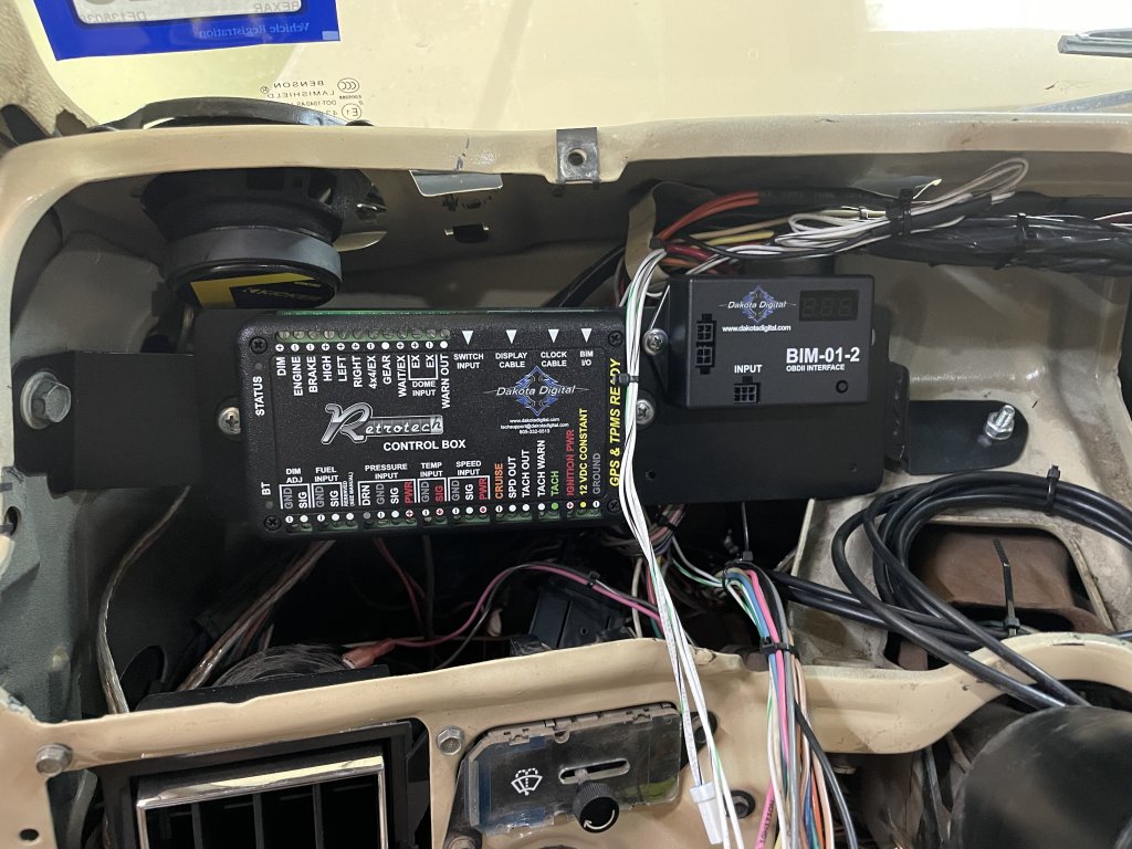

Usually something like this. My shop is about to release a bracket for mounting. It will hold the box vertical instead though.
This is right behind the gauges too since it's kind of a close up picture

Thanks. That's kind of what I was thinking about.
