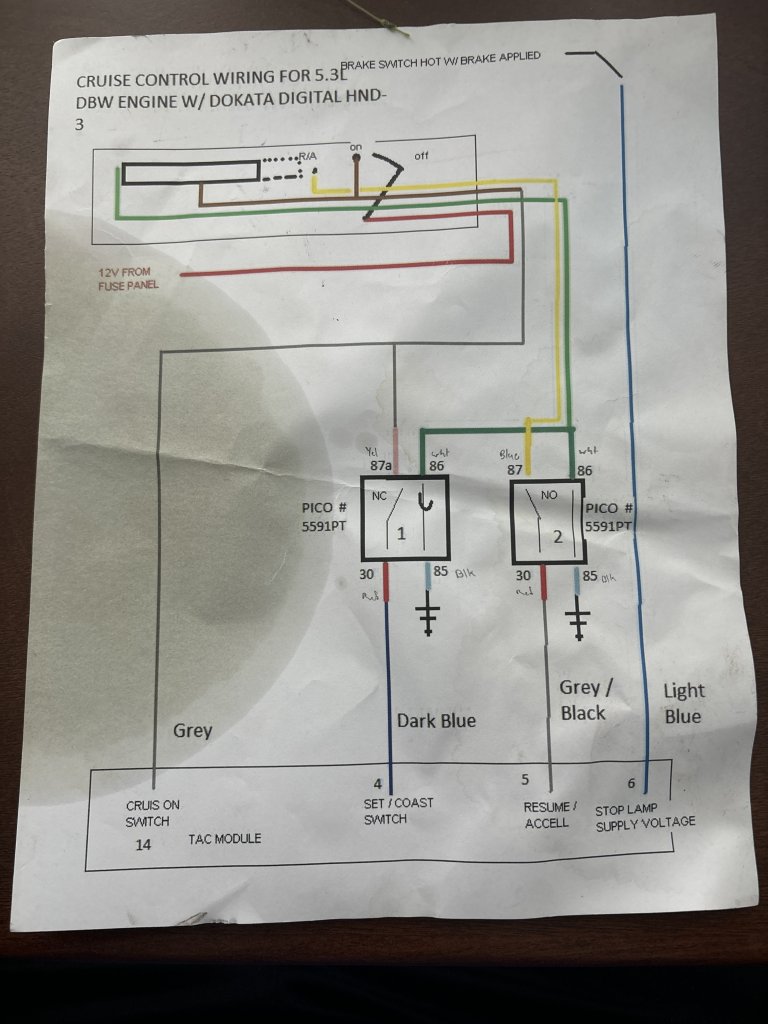

If you are using an aftermarket cruise control stalk, you have to do some relay trickery to get it working. I have a wiring diagram somewhere for it. If you are using factory cruise control stalk, it is easier. You will need the cruise control module from the donor as well as a cable that fits to your throttle body. You will only need to feed it VSS, brake signal, and the 4 control wire signals(on/off, set/coast, resume/accel, and power). Here is a thread on another forum that has the wiring diagram I used for mine. Mine is an 80, so the factory cruise stalk wouldn't work. I used the rostra retro stalk shown in the thread pics, which require some more creative wiring and relay setup to provide the correct inputs.
https://67-72chevytrucks.com/vboard/showthread.php?t=511477
Bextreme04
May 13, 2019
4,571
5,901
350-4bbl
Here’s the wiring and relay setup for the aftermarket cruise control stalk.

Used the OEM stalk on mine connected to a DBC cruise box from a 2000 Yukon: https://www.ebay.com/itm/255149305022 and an AC Delco 10-pin repair plug PT1105 to wire in the leads from the truck. You need to tap into the brake light switch to be able to tap off the cruise with the brakes, wire in ignition power, then the rest of the items based on the wiring doodle on the link above. It took me about 4 hours to do the whole thing, fortunately I had the VSS wire already broke out of the stand alone LS harness, so that connection was a breeze. I intercepted and cut out the 4-wire lead from the stalk, extended the wires through the firewall, and connected everything to a junction block to provide a secure connection.
