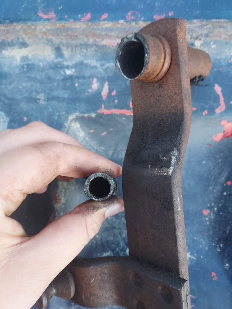

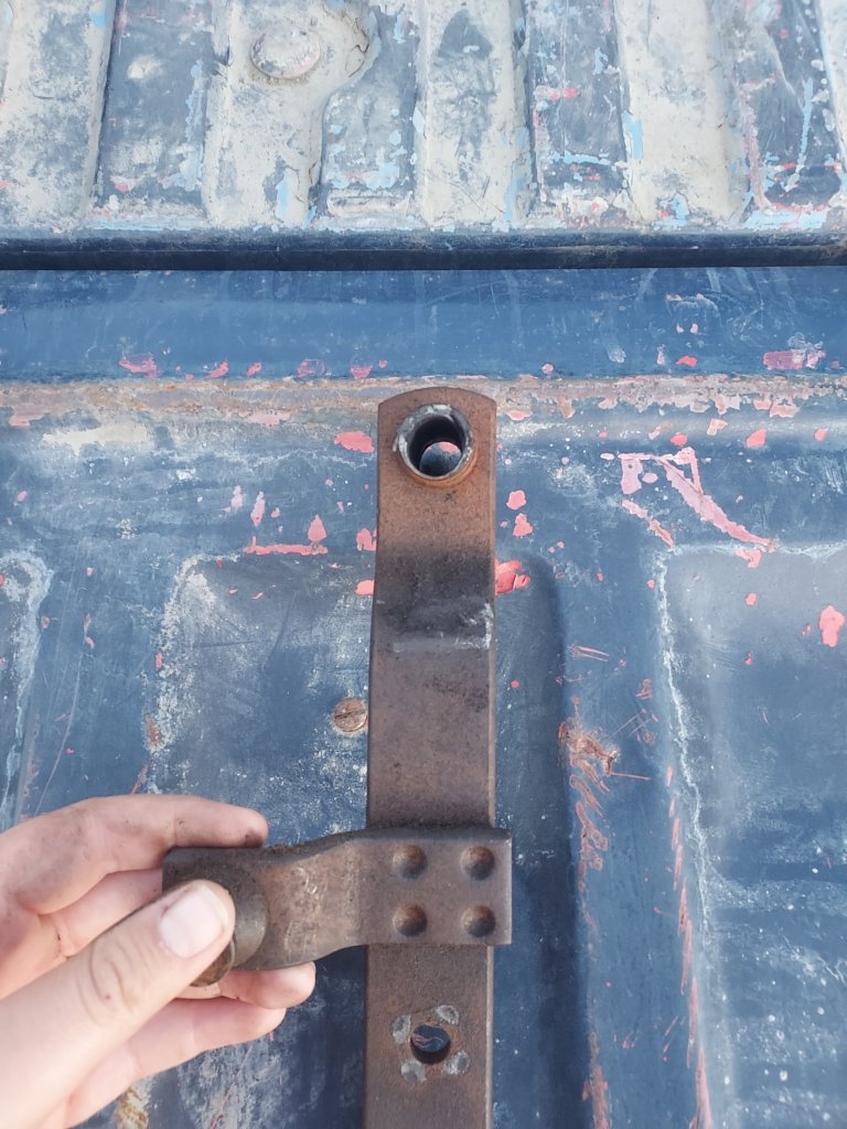

Just tore out the clutch linkage out of my truck because it wasn't going into gear and found out why. Does anyone know where I could buy a new one or should I just have the old one fixed at a machine shop?

I machined a new "housing". Made it larger diameter, made a stainless steel pin, hardened and polished it and a new oversized nylon bushing. Good to go for the next 100 years
