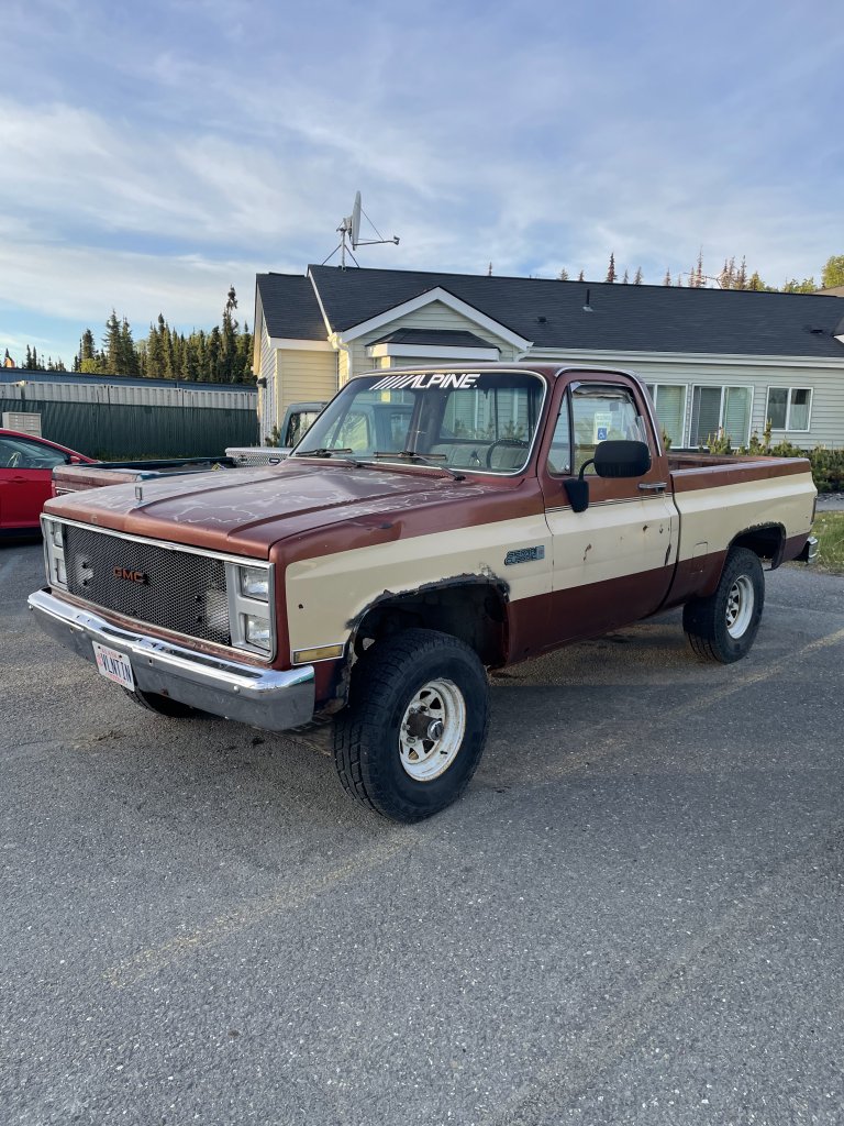

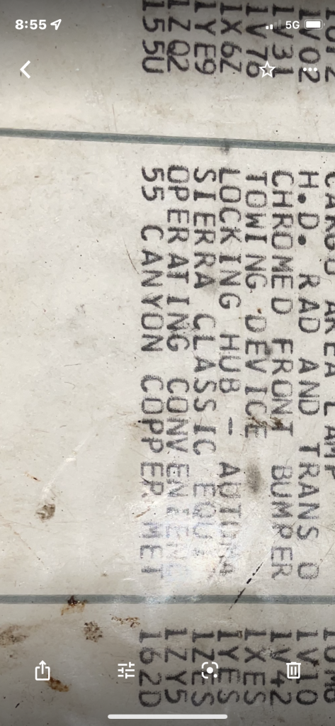

Mine says (55 canyon copper met) too.
…& what exact color is the cream/beige in the middle?
I too would like to buy some touch up paint, without going to a body shop.
