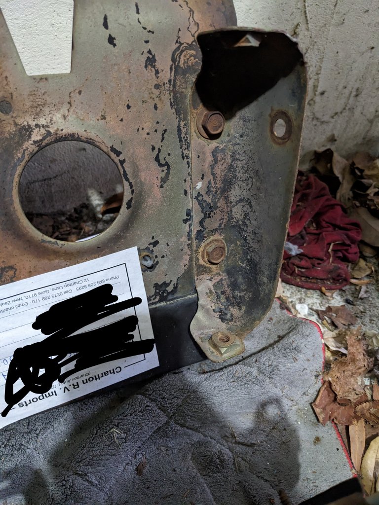

Can someone ID this mounting part on a 75 core support?
Alexc
Jun 23, 2022
NZ
Alex
5.7l
The left side is missing off my replacement core support, need to replace it and struggling to find anything searching for 'bumper mount' which I assume it is...

Thanks mate, while I have you- any idea what size bolts the bumper/lights/bezels etc use? Is there a kit I can get of spares or do I need to individually identify each and source separately??

Sorry, I don’t know what hardware is needed. I don’t think they offer kits but LMC Truck has a lot of the specific hardware.

IIRC The bolt hole facing outward goes to the fender and the downward facing one is the lower grille “valance” thing that fills the gap between the bumper and grille.

I think it goes to one of the two circled holes

Yup…. Outer hole goes to fender, bottom hole is for the lower valance
