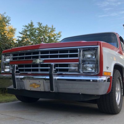

Looking for detailed instructions on wiring cab marker lights, on a 87 Silverado R10???? photos, advice, etc would be appreciated! Thanks

It's a harness with 5 bulbs, 1 power wire that goes to the pull handle for your headlamps, and a ground that goes over to the ground buss behind the dash as well.
You have to snake it thru the A pillar after you drill the holes.
I removed the harness from 87 burb, cut the front part of the roof from it as a template, and transferred the holes and orientation of the holes to my suburban, cut, pulled the wire thru, finished.
They come on when I pull the handle halfway for parking lamps and all the way for head lamps.
