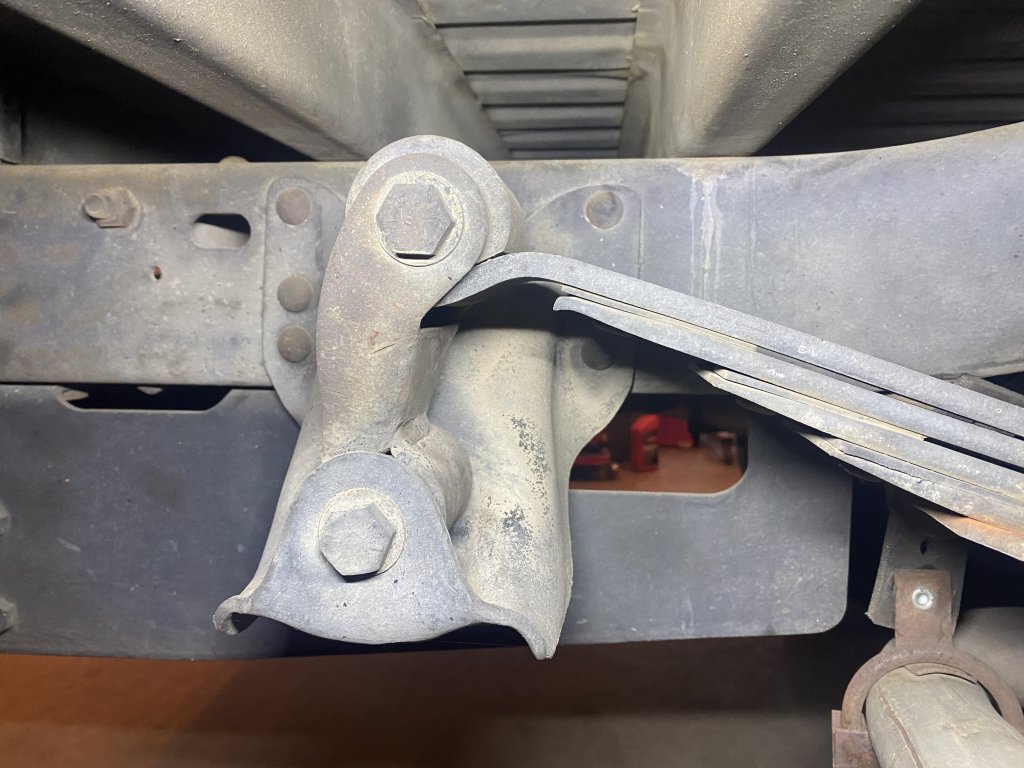

C20 to C10 suspension spring hanger holes.

I see posts that GM punched hole in the frame for the 52 and 56 inch leafs. I’m looking at mine and I’m not seeing another set of holes. Is this not on all of them? Looking to switch to 4 leaf and I am seeing them in 52 inch not 56 inch.

My ‘75 K25 has 52” HD (7 leaf?) springs. I have not checked to see if there is another set of holes for the longer springs.
