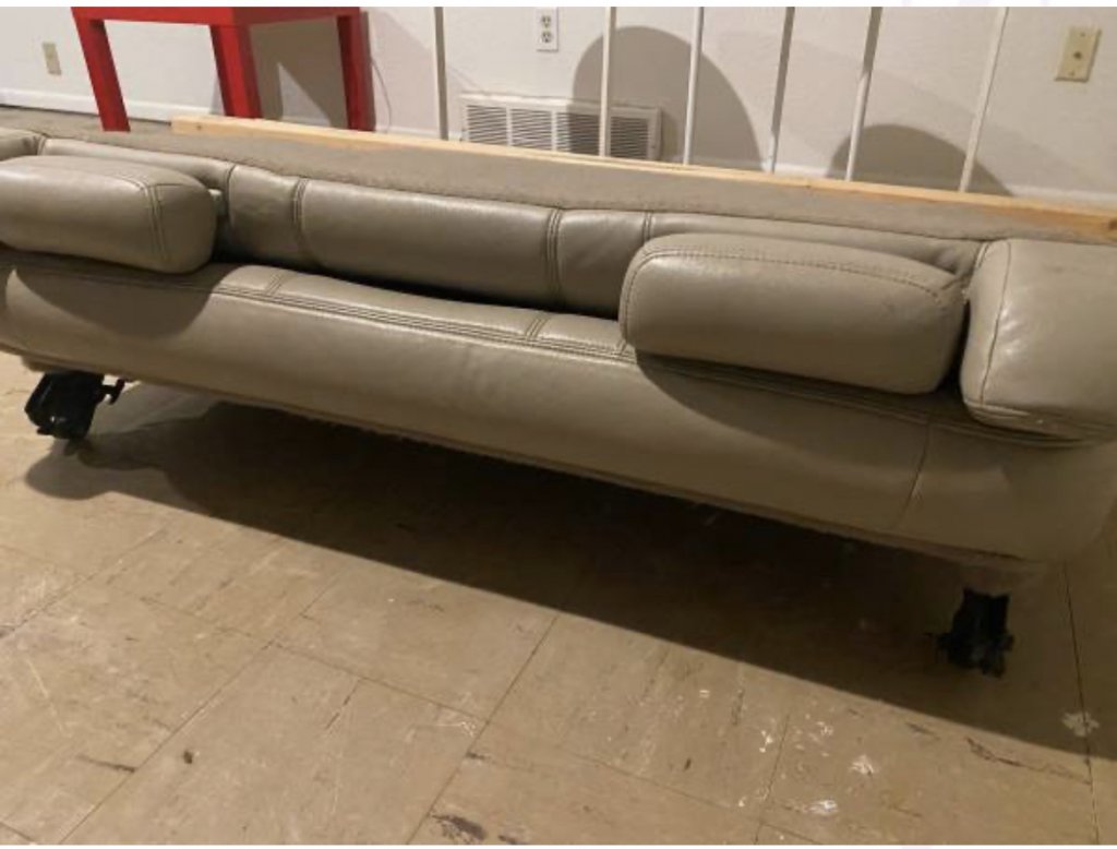

Will an 2002 burb 3rd row seat work in a 83 k20, without too much effort?

Iirc, the mounts are in different locations. I can get measurements to verify tomorrow, if needed.

Are the dimensions nearly identical so the mounting brackets could be switched perhaps with some fabrication including welding?

mounts are different for sure, but you can buy aftermarket mounts to drill and bolt in the older burbs for reasonable ($40?). You can also scrounge the factory brackets from a yard, might need some extra washers to stack the heights right, depending on exact placement.

The early square Burb third row seats bolted into the holes in the cargo area. IIRC the holes have nutserts but not sure as it's been a few decades since I saw that Burb we had set up that way. By 1979 they had changed to a claw and striker setup, where the seat slides into the mounting slots. That continues through the rest of the square Burbs, and the 400/800 trucks are similarly set up. Family has had 5 square Burbs, 2 400s and an '06(800 series) Burbs. The third row usually comes out pretty soon after acquiring the Burb, and I'm the one who pulls it out(or puts back in if we need to haul people instead of stuff). So I have a bit of experience with these heavy bulky things!
I would say the spacing is probably a little different between series too. Also, the square body seat has armrests on it which the newer ones do not have.

Yep, you are correct. '79 was the first year for the quick release style seat.

I knew our '79 had it, and the '75 and '77 didn't. Folks took the seat out of the '75, didn't put the bolts back in the holes, and that's how we found out the exhaust had a leak or two. Those holes go clear through the floorboard.....

Lol, yep. My '78 has the bolt in seat, my exhaust ends at the rear axle and I can't drive around with just the driver window cracked. If I do, it pulls the fumes right in. With a couple windows down, it doesn't seem to pull fumes in. I also have to lube the threaded holes from time to time, since the road spray tends to rust then up.
